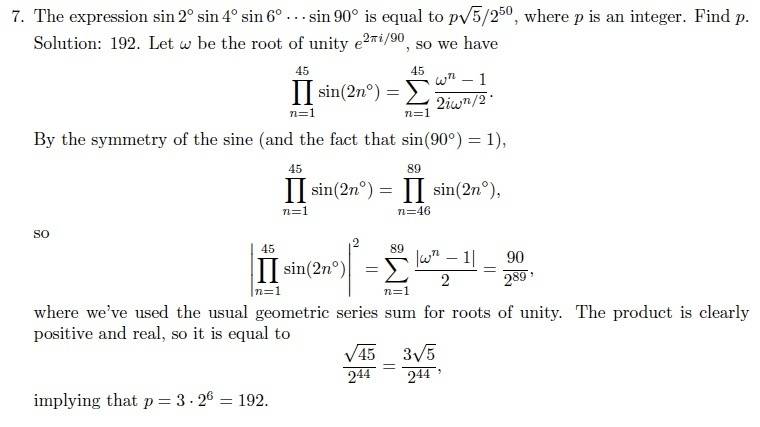

The expression sin(2°) sin(4°) sin(6°)... sin(90°) is equal to a number of the form (n√5)/2^50
where "n" is an integer. Find n
geometric sum: a/ 1-r
I found the solution online but have no idea how they got it... been going back and forth trying to figure it out on my own but I don't understand. Any help would be appreciated everyone. Thanks!

Never mind the online solution
How would you go about finding the answer?
You need to be able to use the geometric sum stuff - so you need to be able to change the product of sines into a sum of something - there are not many different ways to do this.

There are two things I don't understand about this problem. First, when finding the nth root of a number, there should in theory be n solutions. However, the formula produces n+1 roots. Here is how. The first root is simply ##\left(r\right)^{\left(\frac{1}{n}\right)}##. Then you multiply this first root by n additional expressions given by the formula, as you go through k=0,1,...n-1. So you end up with n+1 roots, which cannot be correct. Let me illustrate what I mean. For this...
