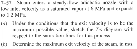

Find the max velocity of the steam in a steady-flow adiabatic nozzle
The discussion centers on determining the maximum velocity of steam in a steady-flow adiabatic nozzle, with a focus on the relationship between entropy at two states. It is suggested that maximum velocity occurs when the entropy at state 1 equals that at state 2, leading to questions about the isentropic nature of the system. Participants express confusion regarding whether the system is indeed isentropic, with one user seeking clarification on this point. Additionally, there are issues with accessing the provided link for the homework statement, prompting suggestions for alternative image hosting. The conversation highlights the importance of understanding isentropic processes in thermodynamics.

According to the solution, the max velocity is when the entropy of state 1 is equal to the entropy at state 2. Why is this the case?
My friend says it is because the system is isentropic but I am still very confused. Is the system actually isentropic first of all?
theBEAST said:
http://i.imgur.com/4kztfIs.png

Oh wow, sorry, I did not realize that. Here is the question:
