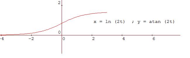

Find the asymptotes of the parametric equations
Parametric equations: x = ln(2t), y = tan^-1(2t), where t > 0.
The graph looks like this:
Red curve plotting x = ln(2t) and y = atan(2t) on axes with ticks at -4, -2, 0, 2, 4, 6 horizontally and 0, 2 vertically; the curve rises from near 0 on the left and levels off near 1.5 at the right end.
My attempt:
Handwritten derivation: x = ln 2t and y = tan^-1(2t); e^x = 2t, so t = e^x / 2; as x approaches infinity, t approaches infinity and y approaches pi/2; as x approaches negative infinity, t approaches 0 and y approaches 0.
Is my presentation correct? Do I also need to consider as x approaches 0 ?
The reasons I ask is because I couldn't find the asymptotes of
Parametric equations: x = 10 - t^2, y = t^3 - 12t.
if I use the above presentation...
Please guide me...
Thanks.
  • Parametric equations: x = ln(2t), y = tan^-1(2t), where t > 0.
The first problem looks fine, although you could have done it without solving for t in the first equation. Just look at what happens to x and y as x gets large or approaches zero. If x = 0, y = pi/4. All this is, is the y-intercept.
For the second problem, there aren't any asymptotes. As x --> infinity, x --> -infinity and y --> +infinity. As x --> -infinity, x --> -infinity and y --> -infinity. For intercepts, set x = 0 and solve for t, then substitute it into the other equation. That will give you the y-intercept(s). Set y = 0 and solve for t, then substitute it into the other equation, to get the x-intercepts(s).
