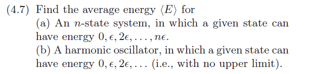

2. Homework Equations [/B]
A) I think , in the question, it is assumed that the system is in contact with a heat reservoir so that its temperature remains constant.
There are n microstates corresponding to the system.
The probability that the system is in the i#_th # microstate is given by Boltzmann Distribution.
##P(E_i) = \frac {e^\frac{- E_i} {k_B T}}{\Sigma_i e^\frac{- E_i} {k_B T}}##
##<E> = \Sigma P(E_i) E_i##
Is this correct so far?
Yes.
