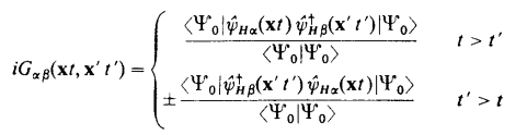

Plugging in the definition is straight forward, I am too lazy to type, I will just quote the book Fetter 1971:
Time-ordering definition of a two-point field operator product, T[psi_H_alpha(x t) psi_H_beta-dagger(x' t')], equal to psi_H_alpha(x t) psi_H_beta-dagger(x' t') for t > t', and plus or minus psi_H_beta-dagger(x' t') psi_H_alpha(x t) for t' > t.
Equation: psi_H_alpha(x, t) = e^(i H_1 t / hbar) psi_alpha(x) e^(-i H t / hbar), relating a Heisenberg-picture field operator to the Schrodinger-picture operator.
Piecewise equation for the time-ordered Green function iG_{αβ}(x t, x' t'): for t > t' it is <Ψ_0|ψ_{Hα}(x t) ψ†_{Hβ}(x' t')|Ψ_0> / <Ψ_0|Ψ_0>, and for t' > t it is ±<Ψ_0|ψ†_{Hβ}(x' t') ψ_{Hα}(x t)|Ψ_0> / <Ψ_0|Ψ_0>.

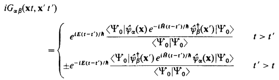

Two-case expression for the time-ordered Green function iG with alpha, beta indices, as a function of x, x', t, t', using ground-state expectation values and exponentials in energy E and time difference t minus t', with a piecewise definition for t greater than t' and t' greater than t.
Up to here everything is very straight forward, in particular, since we are working on free electron gas, ##E=\hbar \omega##
However, I have no idea how to arrive here:
Equation for the free electron gas Green function in Fourier space: iG0 equals a Kronecker delta times V inverse times the sum over k of exp(ik.(x-x')) exp(-i omega_k (t-t')) times step functions in t-t' and in k relative to k_F.
I understand that ##e^{ik\cdot(x-x')}## is from terms like ##\psi=e^{ikx}c##, however, the term ##e^{-i\omega_k(t-t')}## the sign doesn't look right to me for the two time region should have different signs in the exponential. Also, I don't know how to deal with the exponential sandwiched between the field operator. The step function in time is from the two pieces of time regions, but I am not sure on the step function in k. I may be from the filled Fermi sea.
I understand this is a very simple question. However, I have been sitting whole day dealing with this. Any help will be appreciated.
You simply have to think about, how the ground state looks like! Note that at ##T=0## the system is in a pure state of lowest possible energy under the given constraints. First think what is the constraint here!
