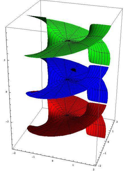

But let's get back to just plotting a part of this function pertaining to your question and since the difficulty lies with the multivalued-ness of the function, we'll plot the imaginary component. And the easiest way to do this is to define say three parts:
[tex]f0[z]:=\log(1+z^2)=\ln|1+z^2|+i(\text{Arg}(1+z^2)[/tex]
[tex]fp1[z]:=\log(1+z^2)=\ln|1+z^2|+i(\text{Arg}(1+z^2)+2\pi)[/tex]
[tex]fm1[z]:=\log(1+z^2)=\ln|1+z^2|+i(\text{Arg}(1+z^2)-2\pi)[/tex]
And that's not at all difficult to plot in Mathematica:

I should point out the plots have a spurious discontinuity at [itex][1,\infty)[/itex] and is due to the plotting software. The actual multi-function is of course analytically continuous there. There are ways to make the plot smooth there but are involved.
And you'll notice I placed a black dot at [itex]Im(f0<i>)</i>[/itex]. But this does not in itself answer your question. I've not created or rather, I've not excised a single-valued part of this multi-valued sheet with a branch-cut at [itex](\infty,1][/itex] such that it is analytically-continuous (and single-valued) everywhere except at the branch cut and having the property of [itex]\text{mysheet}(i)=\ln(2).[/itex]. Can you do that? I'll give you a hint: half of blue, half of red, and get rid of green. :)
