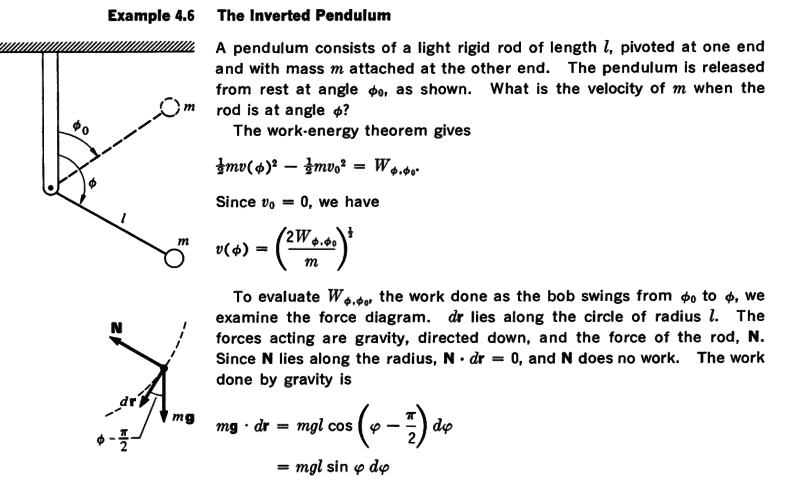

Question is in the attachment
I understand the concept and ideas, but the geometry evades me.
In polar coordinates, we have two components, \hat{r},\hat{\theta}
I know that you just integrate the dot product of \vec{F} and d\vec{r} with the boundaries of position, but how did we find the angle between the two vectors?!
... the question in the attachment is:
"What is the velocity of m when the rod is at angle ##\phi##?"
... which is answered in the rest of the attachment.

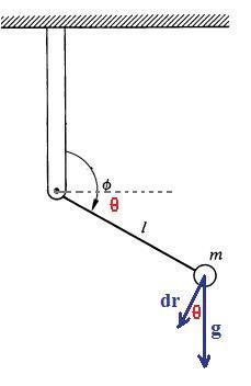

I should have been clearer. I know the concept behind the problem, I know how they solved, just not where they go the cos(\varphi-\frac{\pi}{2}<br /> <br /> That perplexes me. The dot product equals the magnitude of each vector multiplied by each other, times the cos of the angle between them. <br /> <br /> I don't know how they determined the angle.

Can you show that the two angles marked θ in the picture are equal? [EDIT: The dotted line is horizontal]

... that is why I suggested you draw out the bigger diagrams. The exercise of resolving components gets you focussed on how the angles are related to each other. TSny has done one for you.
I didn't even realize that those angles were equal...
I have not a clue how to prove they're equal.
Construct another horizontal auxiliary line through the mass m. Also think about how the vector dr is oriented relative to the rod.
