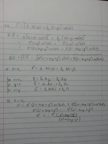

I really have no idea how to go about solving this problem. Initially I was thinking I was just playing around with the vector equation by seeing what it looks like when I plug in different values of x and y and when t=0 or 1. Here is what that looked like:
Handwritten derivation on lined paper: E = [a_x A(x+y) + a_z B(x-y)] cos(wt), expanded for |E| and E·E at t=0 and for x=0, y=0 and x=y, then setting E = 0 to give A^2 = -B^2(x^2-2xy+y^2)/(x^2+2xy+y^2).
Can someone please help point me in the right direction?
