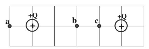

3 points (a,b and c) and two identical positive charges. How do you find MAGNITUDE of the electric field at the 3 points? I just need to rank them, don't need numbers.
all points are on the x-axis:
A (x=0); charge +Q(x=1); B (x=3); c(x=4); charge+Q(x=5)
(Picture attached in the 3rd post)
E= (1/4pie) (q/r^2)
I just focused on the r^2 since everything in the formula is the same.
for point A: 1^2+ 5^2 = 26
Point B: 2^2+2^2 = 8
Point C: 1^2 + 3+2 = 10
so would B then have the greatest strength while A has the least?

r2 is in the denominator. You need to add or subtract 1/12 and 1/52, 1/22 and 1/22, etc.
Also you haven't taken into account the direction of the E field from each charge.
Picture attached

Yes, r^2 is the denominator, that's why the smallest r^2 will have the strongest field. Can you please explain what you mean I need to add or subtract?
In that case, would there be no electric field strength at B? since the directions are opposite, so they cancel each other out?
Yes.

In this case, after doing the calculations, would a have the smallest electric field strength since it is -26/25, and then after that would be B with 0 and finally, C?
would you just assume the left is negative while if arrows pointing to the right is positive?
What do you get for electric field at point C ?
Look at the problem statement. It asks about the "MAGNITUDE of the electric field". (That capitalization was in your original post.)
As with number lines, it's fairly standard to consider a vector pointing to the right to be positive, and left is negative.
