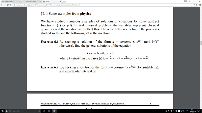

Hi guys, I am having trouble with ex 6.1 and 6.2. I am listed my ans below, and shown working. Could someone please advise. First I am not sure why I have to start with $$x=Ae^{imt}$$. Why cannot start with
$$Ae^{px}$$?
i) $$Aux: -m^2+irm+r^2=0$$
$$\Delta=(ir)^2-4(-1)(r^2)=3r^2$$
$$\sqrt(\Delta)=r\sqrt(3)$$
$$m=\frac{ir\pm r\sqrt(3)}{2}$$
$$x=e^{\frac{-ir}{2}}(Ae^{\frac{ir\sqrt3}{2}}+Be^{\frac{-ir\sqrt3}{2}})$$
ii) For this I followed the same process but came up with, which not enitrly sure if that satisfys the general solution.[/B]
$$x=Ae^{\frac{-ir}{2}}$$
iii) Once again same process and I got
$$x=e^{\frac{ir}{2}}(Ae^{\frac{ir\sqrt5}{2}}+Be^{\frac{-ir\sqrt5}{2}})$$
6.2 why do I have to concern myself with the solution, of
$$y=Axe^{imt}$$
when I am finding the P.I?

I don't know. The image you posted doesn't include the differential equation.
@Mark44 when you say the third is wrong which are in ref to? the quadtratic? The question say I have to use
$$Ae^{imt}$$
are you saying I should replace I am with p?

You're looking for a solution of the form ##x = Ae^{imt}##, not ##Ae^{imx}##. It's probably a typo, but you don't want to assume that ##x = Ae^{imx}## is a solution, with x as both the dependent and independent variables.
Find x'(t) and x''(t), and substitute into the differential equation. It looks like you were doing this to get the auxiliary equation you showed, but the ##r^2## term in your quadratic equation is wrong.
As for your question, "why can't I start with ##Ae^{px}##?" the problem statement says to use ##x = Ae^{imt}## and not otherwise.

I missed that (case i)bit in your posted image. Sorry to have caused some confusion.

Or ##m^2 -imr - r^2 = 0##
Now solve for m to get your solution ##x = Ae^{imt}##.

no worries the print screen is not great
It was clear enough -- I just didn't read far enough.
