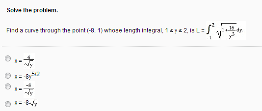

find the curve at the point (-8,1) that gives the integrals length in the picture posted
i literally have no clue what to do. am i supposed to take the derivative of 16/y^3 and square it?

Well, no. The 16/y^3 should be (x')^2 for one of those functions. Which one is it?
