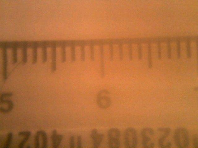

this foto is when the object is at three cm away from camera.it is blurry because i have added a lens that is blury in front of the camera.i only care for an aproximation of the distances.thanks

OK, so, yes. Any object in the same plane as that ruler would use the same scale, regardless of direction.
i.e. a scrap of paper that exactly filled the image would be 2 inches wide and 1.5 inches high. A wall that exactly filled the image and was 4m wide, would be 3m high. (discounting distortion such as foreshortening, etc.)
You can also say that the field-of-view is about 80 degrees. The ratio of distance to field-of-view is 3:5. i.e. if you are 3cm from an object, and it fills the image, the object is 5cm wide. You should check this though, as a 3cm test allows for a lot of error. Try something at 1m.
