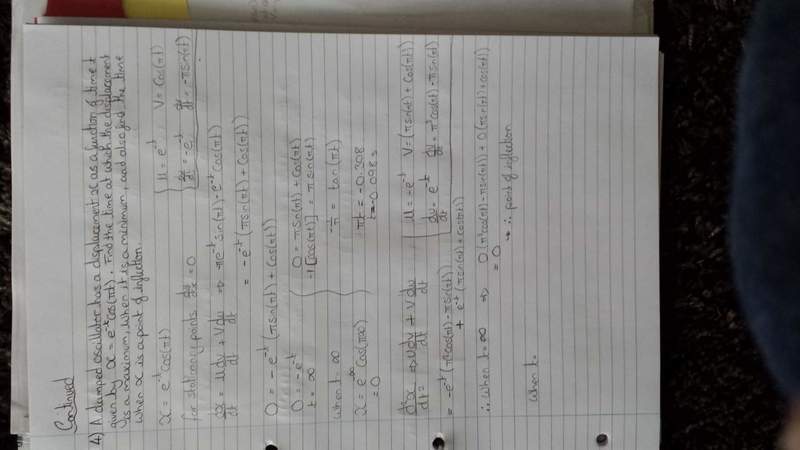

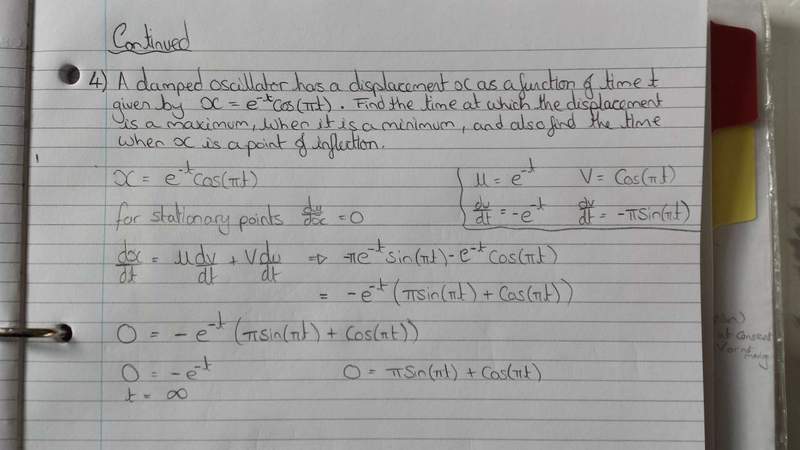

A damped oscillator has a displacement x as a function of time t given by x = e-t cos(∏t). Find the time at which the displacement is a maximum, when it is a minimum, and also nd
the time when x is a point of inflection.
x = e-t cos(∏t)
I've no problem differentiating the equation, its when I come to finding the value of T that I am having trouble with.
Please see the attachment.
  • Handwritten working on lined paper, titled Continued, for question 4 on a damped oscillator x = e^(-t)cos(πt): u and v substitutions, product rule derivative, and setting dx/dt = 0 leading to t = infinity.
Well, you have identified that at t=infinity, there exists a stationary point. What is the displacement then?
A maximum or minimum?
You also have infinitely many other possibilities for stationary points, namely:
(pi)*sin(pi*t)+cos(pi*t)=0, meaning
tan(pi*t)=-1/pi
Which of these stationary points will represent maxima or minima?
When we use t=infinity the displacement (when substituting t=infinity in the equation) we get 0. The nature of the curve at this value is a 'Point of inflection' as shown in the attachment. Regarding the finding T for [∏sin(∏t) + cos(∏t) = 0] Arildno you put a minus sign in front of the ∏sin(∏t), shouldn't it be positive when looking through my workings out? When we do this we get Tan(∏t) = -1/∏.
Please do point out anything that seems incorrect so far...
-Thanks
  • Handwritten calculus working on lined paper, rotated sideways: solving for a damped oscillator's displacement x = e^(-t)cos(πt), with derivative lines, a set-to-zero step for turning points, and a result t = 0.308 approx.
I hastily removed my minus sign, because it was, as you point out, incorrect.
