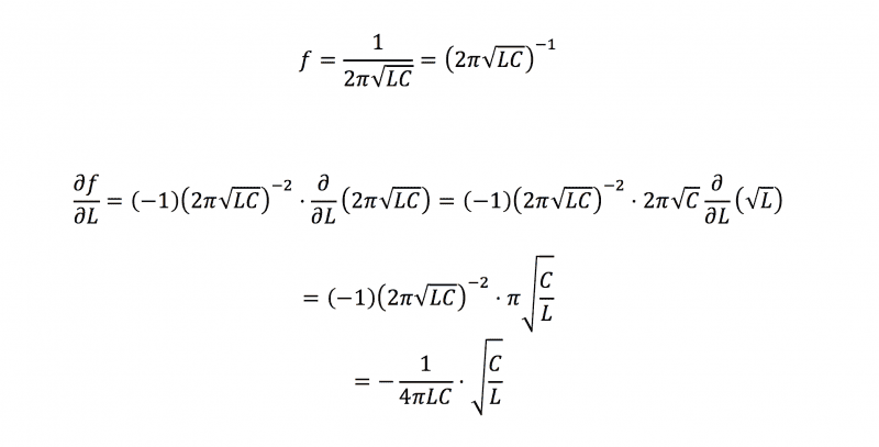

Is this an ##LC## circuit? If so, you may want to be careful about how you are taking your partial derivatives.
For example, here is the partial with respect to ##L##:
Handwritten-style math derivation of f = 1/(2π√(LC)) = (2π√(LC))^-1, followed by the partial derivative of f with respect to L, simplified to -1/(4πLC) · √(C/L).
Are you sure that you can just pull the sqrt C out like that? I mean if we hypothetically multipled C^(1/2) + L^(1/2), we would get LC now, not sqrt LC, right?
Handwritten-style equation: (-1)(2π√(LC))^(-2) · 2π√C · ∂/∂L (√L), a partial derivative with respect to L of the square root of L.
When I did ∂F/∂L, I get:
-[2π (LC)^1/2 ]^(-2) * ∂/∂L[(2π (LC)^(1/2)]
= -[(2π(LC)^1/2 ]^(-2) * (π (LC)^(-1/2) * C ]
**the 2s cancel out on last step.
Aristotle said:
Are you sure that you can just pull the sqrt C out like that? I mean if we hypothetically multipled C^(1/2) + L^(1/2), we would get LC now, not sqrt LC, right?View attachment 83010
Recall from math:
$$\sqrt{xy} = \sqrt{x} \sqrt{y}$$
So we can write:
$$\sqrt{LC} = \sqrt{L} \sqrt{C}$$
Now, because the frequency ##f(L, C)## is a function of ##L## and ##C##, when we take the partial derivatives with respect to a variable, we treat all the other variables as constants. That's why I was able to pull out the ##\sqrt{C}## when taking the derivative with respect to ##L##; the variable ##C## is treated as a constant.

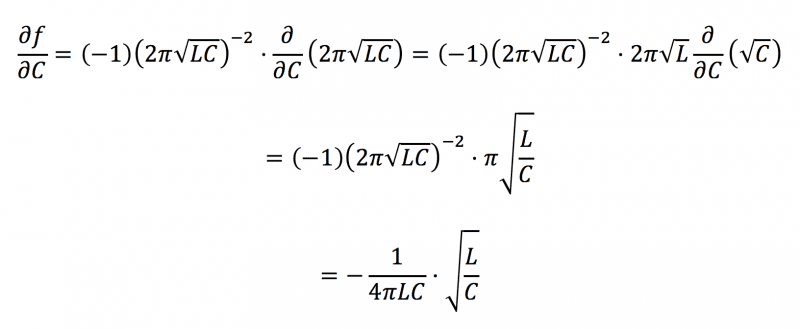

Cleaning up that other partial derivative would give you:
Handwritten-style derivation of the partial derivative of f with respect to C, using the chain rule and the product rule for square roots, ending in the result negative one over four pi LC times the square root of L over C.
Notice the similarities to the other partial derivative.

Okay so I did get the same answer you got for partial f with respect to L----> -1/(4piLC) * sqrt(C/L)
For partial f with respect to C I got answer of ----> -1/(4piLC) * sqrt(L/C)In terms of this equation, partial derivatives are determined.

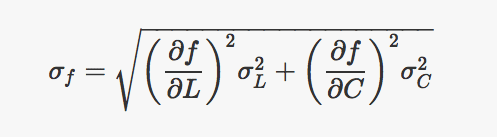

Formula for propagated uncertainty: sigma_f equals the square root of (partial f over partial L, squared, times sigma_L squared, plus partial f over partial C, squared, times sigma_C squared).
So the absolute errors we know is that inductor is 5 percent and capacitor is 8 percent...& know that C= 25 F and L=L=1.12x10^(-25) H.
Then taking C=25 F...I would take that number and multiply it with 8 percent and divide by 100 correct?
##\sigma_L## and ##\sigma_C## represent the errors associated with measuring the inductance and capacitance of each component.

I think you are referring to this equation from prior:
$$\sigma_f = \sqrt{ \left(\frac{\partial f}{\partial L} \right)^2 \sigma_L^2 + \left(\frac{\partial f}{\partial C} \right)^2 \sigma_C^2 }$$
Perhaps it would be insightful if I included some extra information:
$$\sigma_f = \sqrt{ \left(\frac{\partial f}{\partial L} (1.12 \times 10^{-25}, 25) \right)^2 \sigma_L^2 + \left(\frac{\partial f}{\partial C} (1.12 \times 10^{-25}, 25) \right)^2 \sigma_C^2 }$$
You need to evaluate the partial derivatives at the point ##(L, C) = (1.12 \times 10^{-25}, 25)##. You also need to plug in ##\sigma_C = 2## and ##\sigma_L = ?##. The answer that comes out is in ##Hz##, so make sure to convert to ##GHz##.

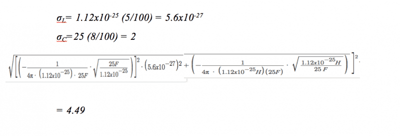

Here is what I did:
Does this seem correct to you?
Handwritten working showing σL = 1.12x10^-25 (5/100) = 5.6x10^-27 and σC = 25 (8/100) = 2, followed by a long square-root expression for uncertainty combining the two terms, evaluating to = 4.49.
***EDIT: Excuse my error in typing from the picture I attached. I forgot to multiply (2)^2 at the far end of the square root. And I meant to have the " ]^2 " part at the very end to be INSIDE the square root.
