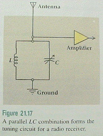

A parallel circuit like that in the figure forms the tuning circuit for an AM radio. If the inductor has a value of 8.6×10-6 H, what must be the maximum and minimum values of the variable capacitor if the radio receives frequencies from 590k Hz to 1670k Hz?
a) Maximum C?
b) Minimum C?
w=2*pie*f
f=1/(2*pie*sqrt(LC))
sqrt(LC) = 1 / (2 pi f)
LC = 1 / (2 pi f)^2
C = 1 / [ (2 pi f}^2 L)
Is the inductor value 8.6E-6 H the variable f in the equation? Are those equations even the ones I use?
590k Hz= 5.9E5 Hz
How do I begin this problem? I'm just really confused
By convention the variable name used for inductance is L. f is frequency. C is capacitance.
C = 1 / [(L)(4pi^2)(f^2)]
Cmax= 1 / [(8.6E-6)(4pi^2)(590E3)^2]
Cmax=8.461E-9 F
Cmin=1 / [(8.6E-6)(4pi^2)(1670E3)^2]
Cmin=1.056E-9 F
*I kept getting this wrong because the equation in the Relevant Equations part had a 2 instead of a 4*
