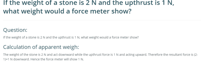

haha0p1 said:
The newton meter shows the downward force of the wax.
I think this is wrong.
As far as I know newton meter measures the net force acting against object.
Look here : (Source : homework.study.com)

There are three forces acting on the object:
1. weight (downwards) - W
2. buoyant force (upwards) - Fb
3. the (tension) force from the meter on the object (upwards) - T
The equilibrium means that
T+Fb=W or
T= W-Fb.
The force meter shows the value of T.
