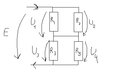

For the life of me I cannot crack the following:
Since I believe the 70 and 30 ohm resistors are in parallel, likewise the 20 and 5 ohm resistors, I tried finding the total current through the circuit by combining them and then combining the two equivalent in series but I'm not even sure I can do that and I really am just stuck at this point.
Your help would be greatly appreciated.
Yep, you can do that.
Ok, I did. So I believe the total current is 2 amps. Is that right? Even if I've got that right, I can't seem to figure out how the current is divided up in the network. I tried to apply KCL with incorrect results. Stuck...
Hmm... how to crack it?
Io is zero, because the line in which it "flows" is just connection between two nodes, You can simplify it by reducing it to one node.
How to get Vo ? (Vo is the voltage that appears at the same time at 20 ohm and 5 ohm resistors). Look at the circut, distribution of voltage is that: 50=I*(70||30+20||5)
The amount of voltage on resistors are proportional to the restistance so Vo=50*(R1/R1+R2) where R1=20||5=4ohm, R2=70||30=21ohm. Vo=8V

Are You sure about the current Io can't be zero ? The two nodes which are connected with this simply line (where Io "flows").. what is the resistance of this line ? (since ALL the resistances in the circut are represented by a resistor, no other resistances are allowed). Then what is the current Io? No resistance, no voltage drop. Infinity ? Zero ?

Really strange way to solve problems. What is the voltage drop in the line where Io flows ? (since it is no resistance). You see, that's the diffrence.. When you will asume there is one node (not two, where Io "flows" between them), what You can surely do, there is no current.

the reason is simple, all the resistances in this circut are represented by resistors. If branche have no resistance it can be simplified to one node. Would You agree ?
If You will look ath cicrut Your way, two nodes, which is incorect for me, then Your solution is good
Another edit of this post:I am electrical engineer. My answer might be strange for You guys because I'm from Europe.. and I suppose most of ppl here are US. Maybe you analyze circuts in some other way.. dunno

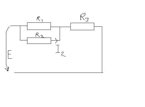

What next ? If You want to go by way selected by I_am_learning ..
Current in the second parralel brach (20 and 5 ohm) is 2A in total (just like in the first one) You will need to find how the current flows, what is the distribution.
Like before I(5ohm)=2A*(20/20+5)=1,6A and I(20ohm)=2A*(5/20+5)=0,4A. Write it on the schematic of Your circrut. Now You see that some of the current in 70Ohm branch (it's 0,2 A) must flow to 5Ohm branch. So it must flow thru "Io line". Hope it's clear.
But like I said, for me it won't work. The reasons are like I stated before. For me Io=0A (How You would use Kirchoff law for this "Io nodes". It needs to be one node to use Kirchoff law!). But whatever.. the book says something else

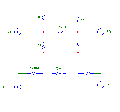

The mesh (loop) method can be used to solve this network.
If the fact that Io is carried in a wire and not a resistor seems confusing, try this:
Replace the wire with a resistor of value R and solve the network; obtain an expression for the current in the resistor R. I get 250/(63*R+1250). If the value of R is allowed to approach zero, then in the limit the current will be 250/1250 = 1/5 = .2

Surely it is obvious this question was deceptively simple, though not to the level of a trick question.
That it was deliberately designed to highlight the issue now being debated. That blind use of kirchhoffs laws can get you into trouble.
You have two voltage dividers of unequal ratio in parallel across a common supply with a direct connection between their division points.
You can regard this as an unbalanced bridge or solve it as I am learning has done.
