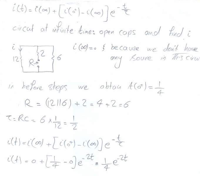

darwinharianto
42
the question is to find I(0)- and I(0)+
the I is at the
what I have attempted
finding Req on the right side
I eliminate the capacitor and Req = 12*6/(12+6) = 4
so Vc (0)- = Req/(Req+12) *18 = 9/2
T = Req*c= 4*1/12 = 1/3
so V(t) = 18/4 e^(-3T)
so I (0)- = V(t)/12 = 3/8 e^(-3t)
but I don't know how to find the I(0)+
sorry for bad English and bad picture
thx for replying in advance

Hello darwinharianto
See the attachment.
See the attachment.
oic
thanks a lot
so no need for me to the e^x
because the assignment before got e^x for the V
as you know before t(-) we assume that our circuit is in steady state so we don't have exponential form.however after t(0) capacitor tries to be discharge with RC period time so exponential form will appear.
if you want exponential form of i after t(0) follow the attachment.
thanks a lot :D
now I do understand it
