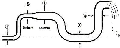

Use the picture as a guide. P is the pressure in the pipe, and vi is the speed of a non-viscous incompressible fluid at locations i = 1,2,3,4,5.(For each statement select G-Greater than, L-Less than, or E-Equal to).
A) P1 is ... P4
B) v1 is ... 2v3
C) P4 is ... P5
D) P1 is ... P2
E) v4 is ... v5
F) P3 is ... P4
G) v1 is ... v2
Bernoulli's Equation p + .5ρv^2 + ρgy
Continuity Equation: A2*v2=A2*v2
A) P1 < P4 because P1 has a higher velocity, so pressure must decrease to compensate.
B) v1 > 2v3, if the diameter is doubled, the velocity is quadrupled as per continuity equation
C) P4 > P5 due to gravity (ρgy)
D) P1 > P2 due to gravity
E) v4 > v5, if v4 has more pressure, it has higher velocity
F) P3 < P4 due to gravity
G) v1 > v2, since P1 has a higher pressure it has a higher velocity
Is my reasoning correct, or do I have something backwards? I guess my main confusion is what effect gravity has on velocity of flow?
Those all look good to me except for E and G.
What does the Continuity Equation say about the velocities?
