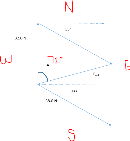

  • #34
@haruspex
This was the previous diagram i had made, it forms a triangle instead of a parallelogram. I labelled angle A .
SinA / 38.0 N = Sin55° /32.9 N
  • #35
Yes, that looks good.
  • #36
Ok so here is my final answer38.
c = (a^2 + b^2 – 2abcosC) ½
c = ([32.0 N]^2 + [38.0 N]^2 - 2[32.0 N] x [38.0 N]cos55°) ½
c = 32.9 NSinA/a = SinB/b = SinC/c
A = 72 degrees (approx.)
net force = 32.9 N (North 72 degrees East)
does this look right?
  • #37
Draw that direction on your diagram. Does it look right?
  • #38
is the correct direction (East 72 degrees North)
  • #39
I didn't say your answer was wrong, just asked if it looked reasonable. You should always check that where possible.
  • #40
oh, ok, so i based the direction of this diagram.
the force is pulling the object 72 degrees east of north
  • #41
Ok!
