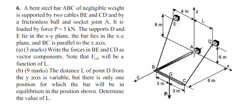

I am kind of confused as to why CD will be a function of L.
For BE i think it is ( -4i + 8j - 8k)
For CD i think it is (6j - 8k) ---> I don't think there is any i value because they seem to be lined up together. I think i am not understanding the question properly. Is it that D is not lined up with C and so there will be an i value?

Well, the distance L is unknown, so how can you be certain the points C and D are aligned in the x-direction? What if L can move back and forth parallel to the x-axis?
Ok that makes sense so L is unknown and it can be anything, which is later confirmed in part(b). So Can you please help me in part(b) ?

First i broke BE into components and i got 0.33BE(i) + 0.66BE(j) - 0.66BE(k) ----------(1)
Then there is a ball and socket joint at A so it is broken into components Ax, Ay, Az ------------ (2)
Force at P = 5kn so it is simply 5 Kn (j) ----------- (3)
Problem arises at CD. This is what i think looks like when you break CD into components given that L is unknown
-------------- (4)
Now after that I would take x component from each of the above equations and combine them together, same with y and same with z. This way i would have x components of all the equations separated in one equations and then same with y and z and i can set the coefficient equal to zero and try solve for it but there are too many unknowns.
Next step is to take moment around A and set it to zero but again the CD is the problem as there are too many unknowns :(
