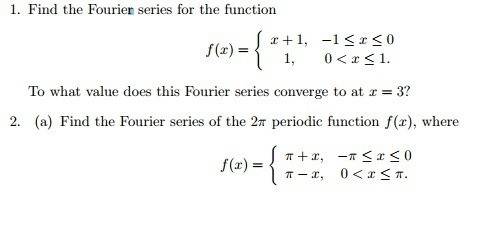

Hello guys,
I have problem with the Fourier series, since we had only one lecture about it and I cannot find anything similar to my problem in internet.
should we consider for the first f(x+1) integrated from -1 to 0 ?
http://img819.imageshack.us/img819/3508/wbve.jpg
when I use that i can find Ao= 3/2?
and about the extra info the lecturer told us if it is even it converges to 1/2 of the value, so may I consider if the series is even it converges to 1.5?
I think 2nd one is similar to the 1st one

Where did that "f(x+1)" come from? You are given that f(x)= x+ 1 for -1\le x\le 0 and f(x)= x for 0< x\le 1.

Say you want to calculate
$$a_n = \frac{2}{L}\int_{-L/2}^{L/2} f(x)\cos\left(\frac{2\pi n}{L} x\right)\,dx.$$ For the function you're given, L=2. Because it's piecewise continuous, you need to break up the interval of integration to correspond to each piece.
$$a_n = \int_{-1}^{1} f(x)\cos(2\pi n x)\,dx = \int_{-1}^0 f(x)\cos(2\pi n x)\,dx + \int_0^1 f(x)\cos(2\pi n x)\,dx.$$ In the first integral on the righthand side, ##x## is between -1 and 0, so in that integral, you replace f(x) by ##x+1##. In the second integral, ##x## is between 0 and 1, so you replace f(x) by 1. You need to understand this part because what you wrote down was gibberish.
You now have
$$a_n = \int_{-1}^0 (x+1)\cos(2\pi n x)\,dx + \int_0^1 \cos(2\pi n x)\,dx,$$ which is left for you to evaluate. You calculate ##b_n## similarly.
Hey guys, I've made some progress, I think I've solved the problems
http://imageshack.us/a/img59/9217/s0du.jpg
For the 1st question I got for An and Bn these things:
http://imageshack.us/a/img543/6600/6kl1.jpg
and the final answer should be multiplied by 1/2 and 3/2 ( Ao ) which forgot to include.
http://imageshack.us/a/img689/6442/f6yz.png
2nd question I got only cosine terms since the function is even with period 2pi
so for An I got this : http://imageshack.us/a/img35/7937/06ha.jpg
and for the final answer when I subsitute the d^2y/dx^2 with \sum-Cnn^2cos(nx)
and y with \sum-Cncos(nx) to be equal to An
and got this:
http://imageshack.us/a/img5/4756/89rb.jpg
Hope I am right and thanks
