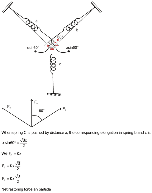

Block of mass #m# is attached to 3 springs of equal spring constants ##k##. Angle between the springs are ##\frac{\pi}{3}## with Block at its center. If the Block is pushed against vertical wall and released, find the frequency of oscillation.
Probably there is no need to assume small oscillations.
##\omega = \sqrt{\dfrac{k}{m}}##

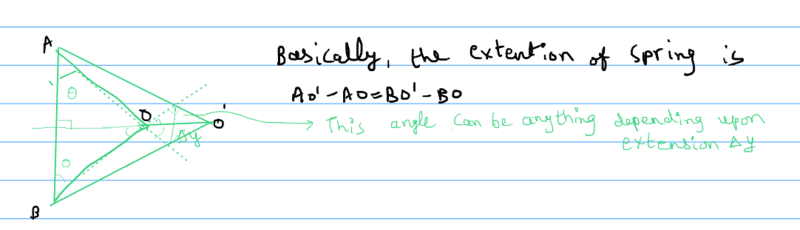

I am attaching the solution given, but I am not convinced with the approach. I am also asking for some suggestions and hints if I am wrong or is there any other way around.
The thing I do not understand is the arguments from geometry they have made. How they can conclude the extension of spring is ## \sin \dfrac{2\pi}{3}## because the projection they have drawn can subtend angle any other than ##\dfrac{\pi}{2} ##. To demonstrate this, I am also attaching a hand-drawn picture. I gave several thoughts on this problem, but not sure what to do.
Please show me some general method to approach such a problem. Thank you.
The question ought to state that is for small perturbations x.
However, you might care to challenge the solution for another reason. Consider the case where the angle is zero instead of 60°.
Also, I assume the solution should read "the corresponding elongation in a and b".

Even in the small oscillations how the elongation would be ##\sin \frac{\pi}{3} ##. The projection of spring A to spring B need not to be perpendicular ? Right ?!
It is not a question of the projection of one spring on the other; it is the projection of the vertical displacement x on the springs. (And as I hinted, ##\sin(\pi/3)## is wrong.)
If you have trouble seeing that, try this:
Let the horizontal distance from the top of A to the centre line be H.
When the spring is at ##\theta+\Delta\theta## to the vertical, the length of the spring is ##H\csc(\theta+\Delta\theta)##, so its extension is ##H\csc(\theta+\Delta\theta)-H\csc(\theta)\approx-H\frac{\cos(\theta)}{\sin^2(\theta)}\Delta\theta##.
Meanwhile, the vertically downward displacement of the particle is ##H\cot(\theta+\Delta\theta)-H\cot(\theta)\approx-H\frac{1}{\sin^2(\theta)}\Delta\theta##.
What is the ratio of the two?

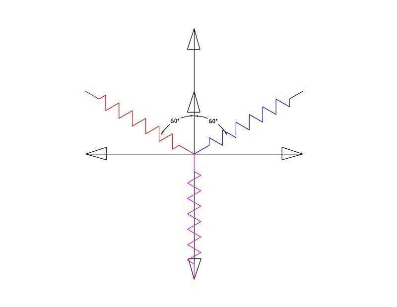

I wanted to clarify my view of the initial condition, assuming certain equal pre-tension in each spring, holding the block in static balance of x and y forces.
Is the diagram and my understanding correct?
Again, can the springs work the same stretched and compressed?
Should we assume that the deflection and oscillation is to be limited to the x-axis by some horizontal guide?
Diagram is correct.
Yes. I think the problem is symmetrical in this regard.
Not really, I think. Springs deflect in both horizontal and vertical components. Only Vertical spring oscillates in vertical component. I assume you are considering x-axis to be horizontal. I am not sure how you think oscillation is limited to horizontal direction, or am I misunderstanding what you say ? What you mean by "horizontal guide" ?

curious_mind said:
Which would mean if elongation is ##\Delta l## and vertical displacement is ##x##, then for very small ##x##, it would be ##cos \theta = \dfrac{x}{\Delta l}## which would imply ##x = \Delta l \cos \theta ##.
No, you have it backwards. The equations I posted lead to ##\Delta l=x\cos(\theta)##.
The equation in post #1 has ##\Delta l=x\sin(\theta)##, hence my second paragraph in post #4.
I see, I think I understood now your argument. Thank you.
