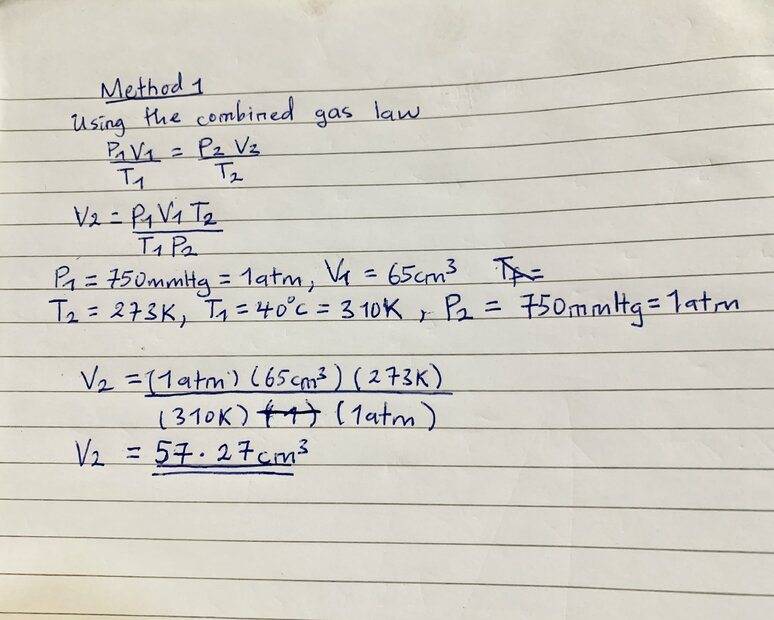

This is my working using the combined gas equation
  • Handwritten working on ruled paper titled Method 1, using the combined gas law P1V1/T1 = P2V2/T2 rearranged to V2 = P1V1T2/(T1P2), with values P1 = 750 mmHg = 1 atm, V1 = 65 cm3, T2 = 273 K, T1 = 40 C = 310 K, and final answer V2 = 57.27 cm3.

Did you manage to solve the problem using P₁V₁/T₁ = P₂V₂/T₂? Post your working - even if you got stuck at some point.
The original question says that the initial pressure, P₁ = 75mmHg, not 750mmHg.
The final conditions are SPT, so P₂ = 750mmHg. (That means pressure has increased by a factor of 10.)
Also, 1 atm is 760mmHg, not 750mmHg. It's wrong to say 750mmHg is 1 atm.
Try again!

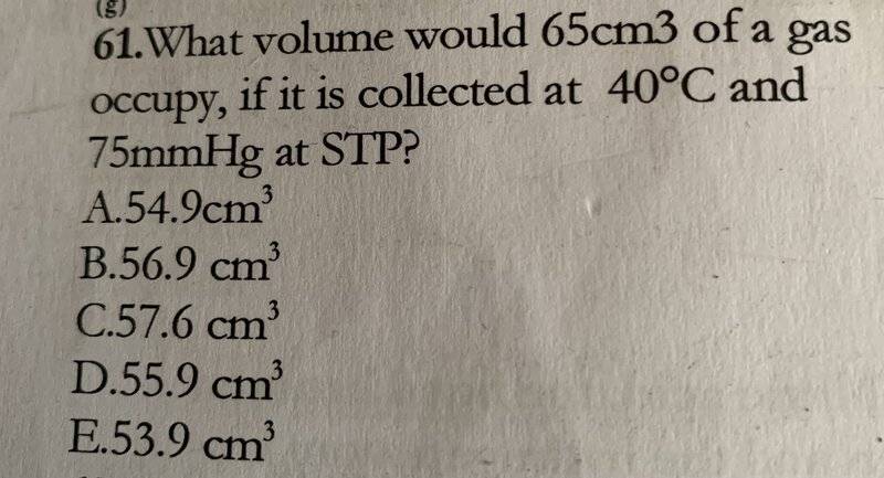

I am confused it’s actually an mcq qeustion, here is the question
Printed multiple-choice gas law question: What volume would 65cm3 of a gas occupy if collected at 40°C and 75mmHg at STP? Options A 54.9cm3, B 56.9 cm3, C 57.6 cm3, D 55.9 cm3, E 53.9 cm3.

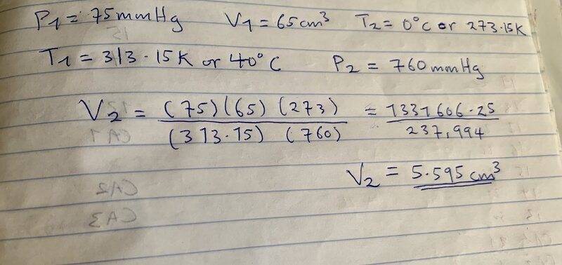

I just did the necessary corrections and solved it solved it again but my answer still doesn't fall among the provided answers
Handwritten gas law calculation: P1 = 75 mmHg, V1 = 65 cm3, T2 = 0°C or 273.15 K, T1 = 313.15 K or 40°C, P2 = 760 mmHg; V2 = (75)(65)(273)/((313.15)(760)) = 1337606.25/237994, giving V2 = 5.595 cm3.

I agree with your answer. Well done! It looks like the question and/or answer-list have one or more mistakes. It happens sometimes.
If we use the STP definition where pressure is 760mmHg and temperature is 0ºC, then I get the same answer as you.
(I would have rounded the answer to 2 or 3 significant figures, i.e. 5.6cm³ or 5.60cm³.)
If we use the STP definition where pressure is 750mmHg and temperature is 0ºC, then this changes the answer slightly, to 5.67cm³.
Make sure you know which definition of STP you are supposed to use. Using the incorrect definition will change the answer (slightly).
A very minor point: you correctly converted 0ºC to 273.15K. But the number you put into your equation was 273.

Yh i agree that there seems to be a problem with the qeustion because i realized that if you change the 75mmhg to 750mmhg then the answer becomes D) 55.9cm3
I still want to know how i could go about with the problem using the ideal gas equation as you said
