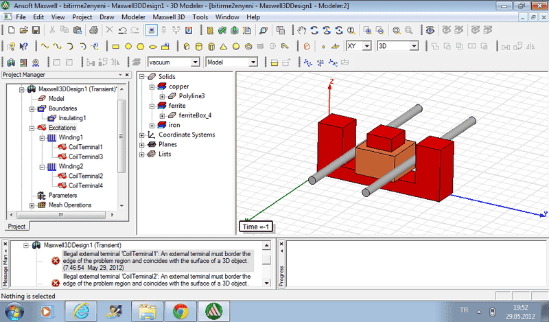

Fuxue I'm now understand that everything you told me. i use copper windings stranded and voltage excitations on coil. So that is very senseless to calculate power . Because i would give the value of the voltage and resistance but i want to explain that i gave this excitations and i could saw the losses do you understand. for example i would give v=100 V and R= 5 ohm so İ = 20 A but if i gave V= 100*sin(W*t) i could see the losses because of the AC variables. Do you understand?
if i have wrong things you can say me... but what do you suggest me to solve?
Because this is my thesis so important for me and I'm grateful to you very very thank you Fuxue

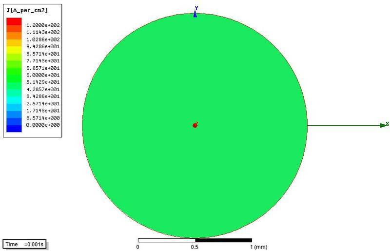

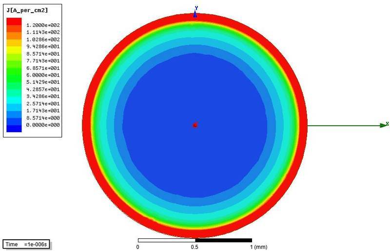

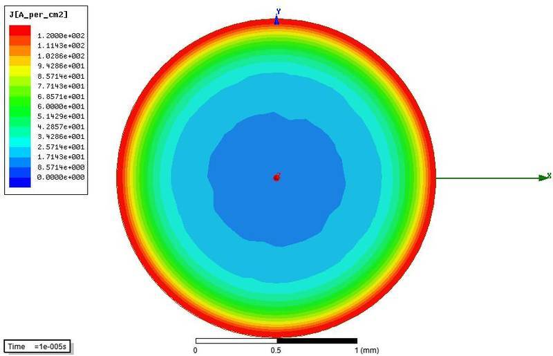

Let's see the copper ohmic loss;
For DC, V=100V, R =5 ohm, we have I=20A, and power loss is 2000Watts.
For AC = 100* Sin(W*t), in this case, 100 is peak current, you need take the rms value for power loss, so Vrms = 70.7. For R = 5ohm, the power loss is , 999.70Watts.
In order to have the same equivalent DC current 100A, the AC peak current need to be 141.4A.
For AC current, if the wire is multi-stranded, then the current density is uniform and it will have the same power loss if the AC rms value is equal to the DC current value. It doesn't matter it is AC or DC because the current density is uniform.
Now, for AC input, if you want to consider skin effect/eddy current at high frequency (say a few MHz), and want to show the different power loss between DC and AC, you need to specify the copper as solid, not stranded, in Maxwell. As I said, in order to specify the copper as solid, you have to draw your winding turns. If it is 10 turns or so, then it will be OK. Otherwise, it is not practical to draw a few hundred turns in Maxwell.

The way to draw a coil taken from Maxwell User Guide is good for stranded currents.
Yes, you need to create every turn to observe eddy effect. How many turns do you have ?

To observe eddy current losses in AC do as Fuxue Jin said. Draw solid turns of copper.
Lots of turns you say. I see no way to analyze this device in full geometry.
You need to reduce number of turns to pretty low number (it depends on computer CPU and RAM memory) or you won't be able to create proper mesh to calculate this accurately.

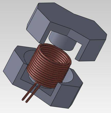

Let's start with what's in the real world and then take a look at what can be done in Maxwell that is close to the real world.
The follow picture is a ferrite RM6 core with 24 turns winding. This is a real inductor model, made by SolidWorks. I don't think Maxwell can create this model.
For this 3D model, after imported into Maxwell, it takes about 20GB memory to generate mesh, and may take a few days for a single CPU machine to finish the solution (given the core material is BH curve, not linear). So for you, it is not practical.
The following is a simplified model.

Before we talk about your project, and I assume you understand what is skin effect, here let's review it again.
In the following pictures, the circle represents the cross section of a solid round wire, with 2mm diameter. An AC current at 1KHZ, 100KHZ, and 1MHZ are applied to the wire. The color represents the current density distribution.
1KHZ
100KHZ
1MHZ
So, due to skin effect, the whole cross section area of the wire is not fully used at high frequency, resulted in high resistance and hence higher power loss comparing DC current.
(to be continued)
  • #55
Now let's talk about your project.
First, since your main interest is the power loss in the copper, so you may just ignore the core loss, and then you don't have to have core in your project. A simple air coil will be good enough.
Second, if you don't need to have a real model representing a real transformer or inductor, you may simply using a circle to represent a round wire, and you can use Maxwell 2D instead of 3D for your project. A circle with symmetry around Z axis in 2D represent a ring in 3D. You can start with only one ring for the winding (one turn winding), and add more rings later (into one winding) to the extend that your machine can handle.
The resistance of a single ring can be calculated by the length and cross section area, so you can compare your simulated results easily.
Hope this helps.

So Fuxue you explain me lots of think but why you don't say me to draw this coil on solid:)) i have lots of machine engineer friends and they could draw me easily. anyway i want to send you my project if you accept by mail or other.
Firstly my first point is calculate power loss on a coil. The secon one is observe that increased the frquency and its effects on power loss.
So Which type of solutiion do you prefer to me? ...
  • #57
My suggestion is to draw a ring in Maxwell, assign copper to the material property, and go from there, to calculate the copper loss, stranded and solid, so you can get used to Maxwell.
After that, you can work on your real model, whether created in Maxwell or imported from SolidWorks.

  • #58
Fuxue you said me that i have to draw a ring but how? for example draw ring by torus is usefull for 3D?Fuxue i want to send you my project and you can easily find what is my problem ,İf you have enough time. Furthermore, it doesn't take your time really. Because my problem very simple and you understood what i want. May it is very easy to describe me something.You don't think that i don't want from you to do my work . Only analyze my work and tell me about What i did wrong or i didnt use
Thanks Fuxue again...
  • #59
I don't have access to Maxwell until next week so cannot look at your project.
You can draw a ring in a few ways. You can also import a ring from SolidWork if you have someone else help you in SolidWork.
In Maxwell, you can draw a torus. You can also draw a circle and sweep around an axis to make a ring.
