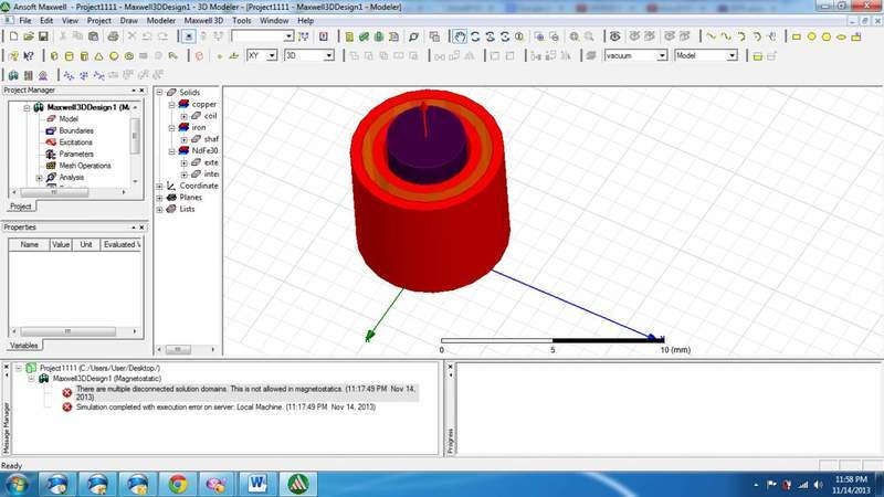

hi gerbi,
i have difficulties on assigning current to my coil as it is wounded on cylinder core. When I want to assign current, this error occur "Excitation 'Current 1':Cannot apply Current Excitation to non planar entity". Any tips and help from you.
Thanks
