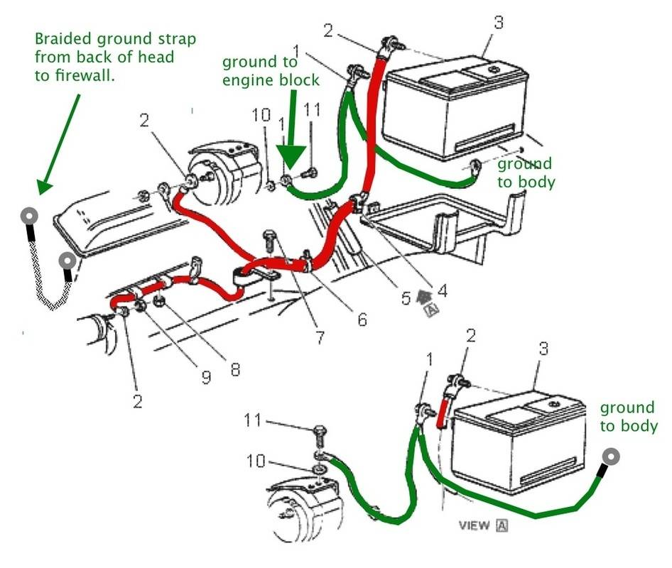

sophiecentaur said:
As has been stated several times above, it's a simple parallel connection. We are talking very basic DC circuit theory here.
I am still confused. If it is a parallel connection, then why not connect the negative of the boost battery directly to the negative of the dead battery? Why do we have to connect it to the body of the disabled car? It would be helpful if you could explain your idea with a circuit diagram.
Here is what I have seen on the net.
In the second image, you can see that the negative pole of the battery is connected to the engine block (or the green cable in the third image; which is also connected to the body). That would be the cable labeled "TO GROUND" for the stalled vehicle battery in the first image.
So the whole car (frame, body and engine) is just an extension of the negative pole of the battery.
Connection no. 4 in the lower diagram is effectively the same as the dead battery negative. The upper and lower diagrams are electrically the same. The only reason for connecting as per lower diagram (subject of much debate on this thread) is so that the spark created when making no. 4 is physically away from the battery and potentially explosive gases.

That’s a nonsense diagram because it doesn’t show both negative connections. Unless there is a load of high resistance in a rusty connection, - joins to - through the body.
