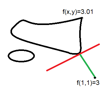

Imaging we look at the surface ##(x,y,f(x,y))## from the top. Then it looks like
Hand-drawn contour diagram: a closed curve labelled f(x,y)=3.01, a small ellipse, a red tangent line touching the curve, and a green segment labelled f(1,1)=3 pointing away from the contact point.
Hence we are looking for a tangent spaces to the curve ##\{(x,y)\,|\,f(x,y)=3.01\}##. And then the one at ##(x_p,y_p)## among them for which tangent space and ##(1-x_p,1-y_p,3.01)## are perpendicular.

I am not sure if I have understood you.
In that case, wouldn't the vector (1.44385, -1.44385) be a better solution?
I have tried to use
I cannot guess the numbers and haven't made the calculation.
If you want to approach it numerically, then minimize the distance between ##(1,1,3)## and ##(x,y,3.01)## under the condition that ##x^3+xy^2+y^3=3.01##.

I don't think anything too complicated is required. See if these (non-mathematician's) thoughts helps.
Point 1
Think of f(x,y) as a formula for the height of a hill, the xy plane being sea-level (ignore earth’s curvature). And imagine you have a map with contour lines.
Do know that ∇f(x,y) is a vector which points in the direction of ‘steepest ascent’ (maximum rate of change of f)?
If you are at P, above (1,1), your height is 3. Now imagine a contour line on your map for height = 3.01. You want the shortest way to get from P to the 3.01 contour line.
The shortest route will be the steepest – so your height will change most rapidly. The direction of the steepest route is given by vector ∇f(1,1) which is <4,5>. You need to move such that when your x-position changes 4 units, your y-position changes by 5 units.
That means Δy = (5/4)Δx
(We’re assuming ∇f(x,y) doesn’t change significantly while you move; it remains <4,5>. This is valid for small enough movements).
