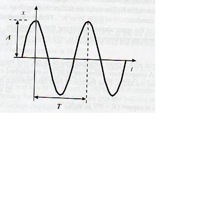

A particle moves with amplitude A and period T (see figure). Express the following in terms of A and T and numberical constants.
a) The time at which the phase is pi/2
b) maximum v
c) max a
d) time at which acceleration is a maximum
I got b and c, but I'm not sure about a and d.
For a, they ask for the time at which phase is pi/2. I know T = 2pi. For d, when acceleration is max, is time 0?
Can someone help me please?
THANKS

T does not equal 2pi
\omega T = 2 \pi
and
\omega = \frac{2\pi}{T}
where omega is the radian frequency, because when you evaluate the sinusoid at t = T, the argument equals 2pi.
x(t) = cos(\omega t)
x(t) = cos(\frac{2\pi}{T}t)
Using this last equation, we can solve both a and d. For a, find a t that makes the argument pi/2. For d, differentiate twice to find acceleration and find the argument that maximizes acceleration.

I'm not getting what you mean by finding a t that makes it pi/2. We don't have any values of t
for a, time has to be 1/4t.
is that right?
differentiating the equation twice gives acceleration = -A omega^2 cos (omega t)
amax = Aomega^2, so t has to be equal to 1?

no. the time at which a phase of pi/2 happens, t, will have T in it.
no. wt must equal 0 or pi for |a(t)| to be maximum.
