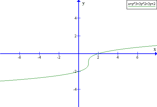

First derivative=maxima/minima/vertical tangent/rising/falling
Second derivative=points of inflection/concave upward-downward
$$x=y^3+3y^2+3y+2~\rightarrow~1=3(y^2+2y+1)y'$$
$$y'=\frac{1}{3(y+1)^2}>0,~y\neq (-1),~y=(-1)\rightarrow~x=-1$$
So the vertical tangent is at x=(-1)
The second derivative:
$$y"=(-2)\frac{y+1}{3(y^2+2y+1)(y+1)^2}=\left( -\frac{2}{3} \right)\frac{1}{(y+1)^3}$$
The answer, i don't know exactly how to interpret it, is (1,-1)

For ##y = -1## we have ##x = +1##, not ##x = -1##.
In the region ##y > 0## the function ##f(y) = y^3 + 3 y^2 + 3y + 2## is (strictly) convex, but for ##y < 0## it has mixed behavior: strictly convex for ##y >-1## and strictly concave for ##y < -1##. Here, the modern terminology "convex" is what older introductory calculus books call "concave up", while "concave" is new-speak for "concave down".
The value ##y=-1## is a stationary point of ##f(y)## (derivative = 0), and is also an inflection point (second derivative = 0).

I assume that in taking the second derivative you are trying to determine whether the arc lies to the left or the right of the tangent.
You might find it easier to swap x and y and ask whether it is a local maximum or local minimum. How do you resolvethat when the second derivative is zero?

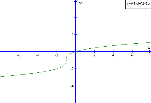

$$f(y) = y^3 + 3 y^2 + 3y + 2~\rightarrow~y'=3(y+1)^2,~y'=0~\rightarrow~x=(-1)$$
$$y(-1)~\rightarrow~x=(-1)$$
The y'=0 line that is parallel to the y-axis is vertical to the x.
The graph is:
Correction:

I think your calculations might have been easier and your result more obvious to you, related perhaps to something already familiar or known, perhaps all visible in a trice rather than the forgettable result of a slog if you had rewritten 15 as
$$x=\left( y+1\right) ^{3}+1$$
Nowhere is there any law btw forcing people to always portray x as horizontal and y as vertical!
