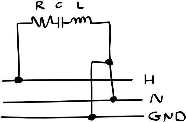

What I thought the actual circuit could like is Figure B, where our dark box is represented by a resistor R, a capacitor C and an inductor L.
If my representation of the circuit behind all this is incorrect, please tell me how it actually is, otherwise, I have a question.
Here is the deal, I was told that there is generally no current flowing through the ground wire. However, if you look at figure 2, you will notice that, considering that the neutral wire and the ground wire should be so-so at the same potential, current would flow through both of them.
After all, in order to current to flow, you just need a potential difference.
Thanks in advance!

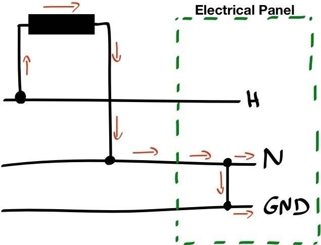

One more question though, If ground and neutral are connected in the electrical panel why doesn't current normally flow from the hot wire to ground through this connection?
(Take a look at Figure C to see what I am thinking)

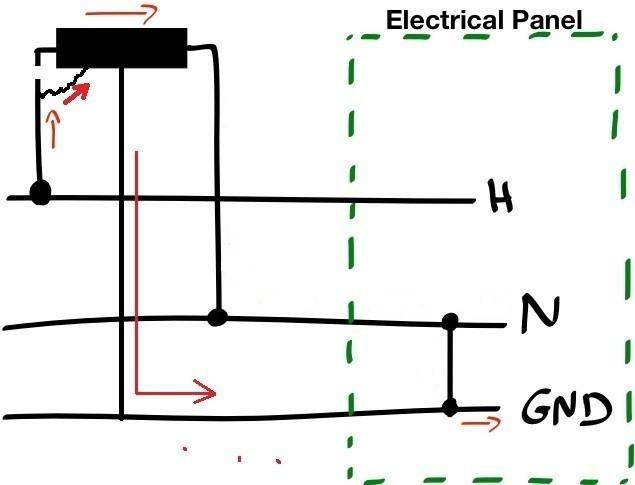

It does. Here's what keeps you safe when a fault occur.
No, Haecifer meant why doesn't it normally flow to ground.
Ground and neutral are both zero potential, so there is no flow between them. One of its mainfunctions is to act like a universal neutral, ensuring everyone has the same reference.
And don't confuse neutral with negative: the Earth isn't sucking-up electrons from the wire.

Thought Experiment:
In your fig B
1. Disconnect your G wire from N at the appliance (R, L, C). Remove that dot from the vertical N wire.
2. Draw a dotted line encircling the appliance (R, L, C) but not touching anything else.
3. Connect your G wire to that dotted boundary encircling the appliance.
Now - the dotted boundary represents the skin of your appliance. It forms almost a Faraday cage surrounding the active components, certainly a cage that keeps tiny fingers away from hazardous parts..that's up to the mechanical designer to provide.
That cage is connected to the ground prong on your appliance cord.
Now - take a close look at your plug on end of appliance cord.
The wide blade is Neutral, earthed near the panel. But it's a large conductor all the way back to your transformer so that it won't develop noticeable voltage unless something is significantly wrong.
The skinny blade is Line, to hot side of panel
The round prong is Earth ground and tied to the Faraday cage. . Notice it's longer than the other two - first to connect on plugging in, last to disconnect on unplugging.
That's what keeps applianve safe. Any current in ground wire comes from a fault in appliance. Ground wire is sized so as to carry enough current to trip the breaker without developing lethal voltage drop.
That's as succinct as i can put it, hope it helps.

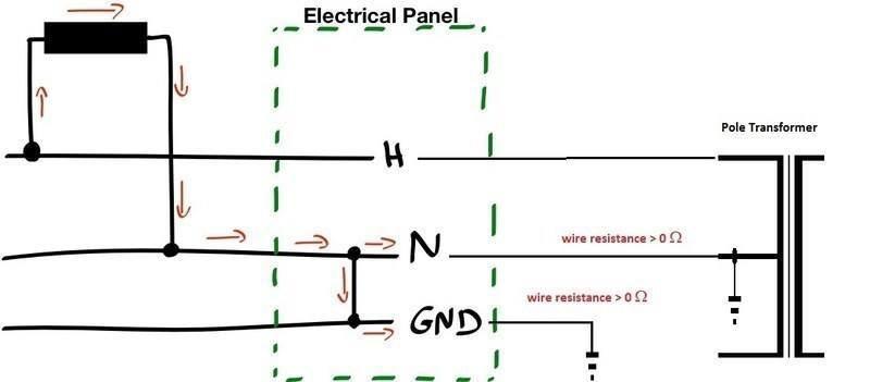

Well. They are very close to zero potential, but being the knit-picker I am, ... Since there's a LITTLE resistance in the neutral wire leading from the distribution/pole transformer and the panels ground wire leading from the homes Earth ground point, there's a small potential. So there is a little current in both. Just sayin'
It's not just the resistance in the connecting cable, the resistive components within the transformer will also contribute to unbalanced voltages when the load on each side is unbalanced. If this effect can't be detected then the transformer was badly designed (i.e. too good for the job)
It might (or might not) help here to note something that's in Digoff's annotated version of the sketch, in posts 6 & 16.
Observe that:
IF you imagine yourself very small and standing just inside left edge) of breaker panel,(not right edge)
AND you draw a dashed circle around just the H and N wires;
When NO fault is present (post 16), ALL the current traveling out on the H wire comes back on the N wire, so your dashed circle encloses equal and opposite currents whose sum is zero.
When a fault IS present (post 6) SOME of the current going out the H wire comes back via the G wire instead of the N wire. So our dashed circle now encloses two unequal currents whose sum is no longer zero.

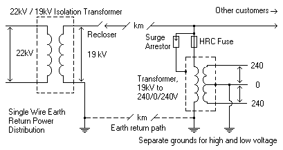

The 'residual current' circuit breaker is a very clever piece of kit - being able to detect a few mA of imbalance in a 100A circuit. Must have saved many lives since the idea was introduced.
There is another form of Earth Leakage Trip which was used in a house I lived in as a boy. There was a very long two wire feed (1km+) to the house with a very skimpy third (earth) wire. Also, an Earth spike. Between the 'earth' terminal on the consumer unit and these Earth connections there was a current operated relay that tripped at a few hundred mA, disconnecting the supply. It's a dim and distant memory now but I guess it was because an ordinary fuse wouldn't necessarily blow whilst there was an unsafe voltage on the exposed case of the fridge etc. We were only allowed a small supply fuse and no electrical cooking or water heating with that supply, iirc.
Probably a little off topic but when you mentioned "(1Km+)" I thought of the Single wire Earth return transmission line which avoids the need for a neutral (transmission line neutral).
