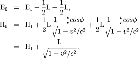

All I am pointing out is that Einstein does not mention it. You seem to be attributing a significance to the doppler shift that Einstein was not.
What? Then where does he get this equation?:
Handwritten-style equations: E0 = E1 + L/2 + L/2; H0 = H1 + (L/2)(1 - (v/c)cos(phi))/sqrt(1 - v^2/c^2) + (L/2)(1 + (v/c)cos(phi))/sqrt(1 - v^2/c^2); then H0 = H1 + L/sqrt(1 - v^2/c^2).
This is from the previous paper on Electrodynamics, where he talks about how the Doppler shift will affect frequency AND intensity of light:
We still have to find the amplitude of the waves, as it appears in the moving system. If we call the amplitude of the electric or magnetic force A or A' respectively, accordingly as it is measured in the stationary system or in the moving system, we obtain
Equation for the transformed amplitude A' in terms of A, the angle phi, velocity v and speed of light c: A' = A^2 (1 - cos(phi) v/c)^2 / (1 - v^2/c^2)
This is the Lorentz transformation for radiant energy. Since it includes light emitted in both directions, the doppler shifts are in both directions. It is greater by the factor [itex]\gamma[/itex] regardless of the direction in which the light moves. Indeed, it could be emitted vertically so that there is no doppler shift at all ([itex]cos\phi = 0[/itex]). The energy of the vertically emitted radiation would still be greater when measured by the moving observer by the factor [itex]\gamma[/itex]. For that reason, I don't see how doppler shift enters into the analysis here. The end result is that, with no doppler shift, the total radiation energy as measured in the moving observer's frame is greater (by the factor [itex]\gamma[/itex]) than the radiation energy as measured in the moving observer's frame.
