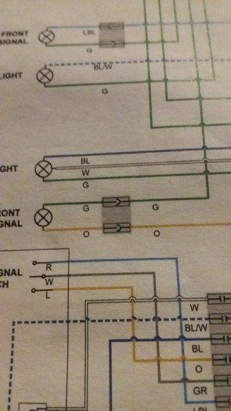

Section of a motorbike wiring schematic showing a column of connector blocks with wire labels W, BL/W, BL, O, GR, LBL, G/R, G/O, LG and B/O, with a horn symbol at lower right.
1) In the above The components in the greyed out boxes the circuit symbol with parallel lines- what exactly are please and what does it do. Those things are there at the start of every wire to every component so they must be important. surely not a capacitor- why an Earth would there be a capacitor on every single wire right after every component

Part of a motorcycle wiring schematic showing front and rear signal lamps, with wires labelled G, BL, W, BL/W and O, and grey-boxed connector symbols on the wires.
2) In the above :There's also the other kind of greyed out box: The one with the circuit symbol with the
curvy arrow thing- that one doesn't look familar at all...

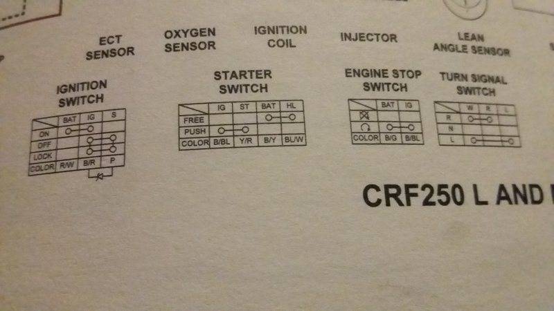

Wiring diagram for CRF250 L and M motorcycle switches, with ignition, starter, engine stop and turn signal switch contact tables, plus labels for ECT sensor, oxygen sensor, ignition coil, injector and lean angle sensor.
3) In the tables again no explanation: BAT, IG,S, W, N, The white unfilled circles with lines connecting them in the table boxes. R and L in turn signal box obviously means right and left... that's about all I can gauge in this annoying schematic. lock, free, push...

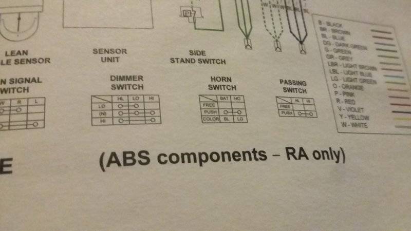

Part of a motorbike wiring diagram showing dimmer, horn and passing switch tables and a colour legend for wire colours such as B-Black, BR-Brown, R-Red and W-White, with the heading "ABS components - RA only".
more :oldconfused:
Colour key legend from a motorcycle wiring diagram listing wire colour codes: B black, BR brown, BL blue, DG dark green, G green, GR grey, LBR light brown, LBL light blue, LG light green, O orange, P pink, R red, V violet, Y yellow, W white.
4) with the colour coded wires- are these the actual colours of the wires in real life?
A multi way connector block.
Hondaboi1729 said:
2) In the above :There's also the other kind of greyed out box: The one with the circuit symbol with the curvy arrow thing- that one doesn't look familar at all...
Probably a pair of bullet connectors.
When the operation in the left column is active, the connections inside the switch is shown in that row. Wires are listed across the top.
Colours are close, but some are striped which I can't see in your pix.

Oh for the striped I think B/G means Blue and green striped wire etc...
No other diagrams sadly :( So have no idea what 1-20 are- in the small owners manual i only count 13 functions: speedo,tacho etc... which leaves me :oldconfused: but I'll call the honda dealer and ask...
As for the rest thank you for helping me understand :)
B is black, B/G is black with a green trace. BL or U is blue. See the color code chart.
