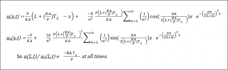

  • #55
I think you might have made a mistake in algebra. I get:
$$kv_x=-\frac{P}{A}\frac{v}{T_2}$$
at x = L
Chet
  • #56
at x = L
Chet
here is my calculation attached.
  • #57
I have no idea what your motivation was for doing what you did, but here's my (much more straightforward) analysis:
$$u_x=-\frac{P}{AK}+v_x$$
At x = L,
$$u=T_2+v$$
So, substituting into the boundary condition for u at x = L:
$$K(-\frac{P}{AK}+v_x)=-\frac{P}{A}\frac{(T_2+v)}{T_2}$$
So,
$$-\frac{P}{A}+Kv_x=-\frac{P}{A}-\frac{P}{A}\frac{v}{T_2}$$

Ok, This is fine.
I then attached a solution. But I didn't get values for λ in a closed form.

$$\cot(λL)=\frac{T_2KA}{PL}(λL)$$
See Table 4.20 in Abramowitz and Stegun.
