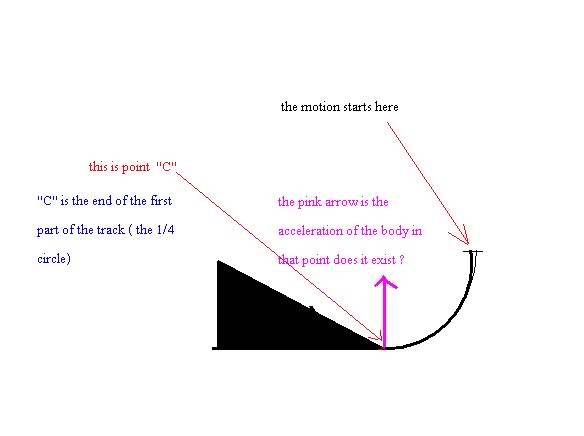

a skater moves from point A to C in a circulaire path as shown in the picture
C is the end of the circular path
find R the force that the ground exerts on the skater at point C using Newten's second law
there is no friction nor air resistance
p-R=ma
well I did this
p-R=0
so that P=R
am I right ? cause I think in point "C" there is no acceleration

I only want to know if there is a perperndicular acceleration in "C" I think that it is 0 because the skater would go up if there was any
Upward? I thought the skater was on flat ice. Does the diagram mean that the skater goes down a ramp and then upward on a circularly curved ramp?
If so, the force exerted by the ice at point C is certainly upward. It must cause the skater to accelerate upward with the centripetal force necessary to maintain the circular motion.
no the skater starts from point "A" with no speed and accelerates downward the uestion is when it arrives at point "c" does it have any acceleration ?

maybe my drawing wasn't clear here's a new one
or let's put the question in another way
define the acceleration of the body in "C3

and the original question is to define the magnitude of the force acting on the skater by the ground
I said P-R=0 so P=R
but if there is a vertical acceleration towards the centre of the circle the equation would be P-R= ma so R = P -ma
so which one is right ?

Okay, we're on the right path! I'm not sure what you mean by P and R, though. I do think the ma force should be included but I'm not sure about it. Were you given any information that would allow the centripetal force to be calculated? If not, then I would change my mind and ignore it. The question would be awfully trivial that way, though: simply F = mg.
yup we have the speed at "C" also ma isn't a force "m" is the mass of the body and "a" is the perpendicular acceleration at point "c" (the pink arrow in the last diagram) I'm in a hurry mate
ma = F is definitely a force! Centripetal force.
are you sure you know what's the question ?
Good point; always a good idea to read the question again! "Newton's second law" is F = ma, so that clears up any doubt we had about whether there is a centripetal force - there is and it is F = ma where "a" is the centripetal acceleration.
I also see what your R force is. Still don't know what the p in "p-R=ma" is.

p=mg where m is the mass and g is 9.81m/s^2
and if there were a centripetal force there the body would continue his circular motion it wouldn't follow a straight line there
Okay, so mg - R(ground force up) = ma
where a is the centripetal acceleration.
Finished? Put in the numbers?

I think we agree there is a centripetal acceleration and force for the circular path up to the point C. If you accept the force a nanometer before C, why does it suddenly become so unreasonable to have it for one more infinitesimally small distance?
what about the first poin of the circular path is there any vertical acceleration ?
the body started with no speed
and I don't know there is something which make no sense in this when i calculated the force it was 2400 N (nothing wrong ) while mg = 800 N
At the top of the circular path, velocity = 0 so no centripetal acceleration.
The skater does accelerate downward as if in free fall. However, a nm down the path there is some velocity and a tiny bit of centripetal acceleration to the left. As the skater continues to fall, velocity and centripetal acceleration increase.
Your 2400 N calc is for centripetal force plus gravitational force, right?
I'm finding it interesting that the centripetal force is twice the gravitational force regardless of the height = radius. Since potential energy is converted entirely to kinetic energy as it falls,
PE at top = KE at bottom
mgR = ½mv²
v² = 2gR
Putting this into Fc = mv²/R
gives Fc = 2mg.
The total force pushing up on the skater at the bottom of the path is three times gravity regardless of the radius. Most interesting! Skateboarders are experiencing 2 G's of acceleration but feeling 3 times their normal weight at the bottom of a bowl.
