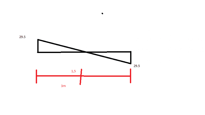

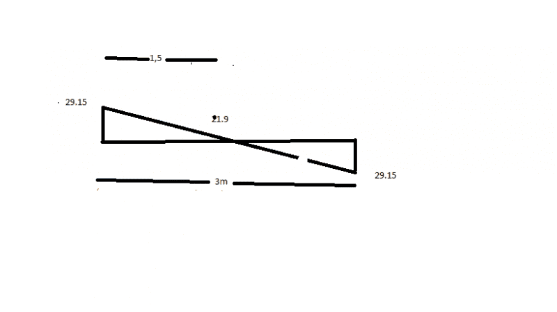

for the sheer moment diagram including the point load i took the moment at point a and 29.15
i then *this load by the distance to the center and divided it by 2 29.15KN*1.5m/2=21.9KN as it is equal at both ends the sheer moment value in the center of the beam 21.9KN
22.5 for the point load
andrewh21 said:
so I have drawn the sheer moment diagram for the UDL alone and also with the point load am I correct in calculating the sheer moment for the UDL alone would be 22.05 KN and with the point load
It's not clear what you have calculated here. What is the moment you obtained at the center of the beam?

  • #31
edited please advice
although my above work may not be correct how to i get the maximum stress due to bending from the sheer moment diagram?
Thanks Andrew
  • #32
Do you know how bending stress is calculated?
The shear force diagram (not sheer force), is a tool used to calculate the bending moment.
  • #33
so assuming that my shaer force diagram is correct what do I do next
  • #34
Going back a couple of posts, what value of the bending moment did you calculate at the center of the beam? You never clarified what you had posted previously.
  • #35
the bending moment the figure I came to was 23.01KN
sorry steam king what would you like me to clarify?
