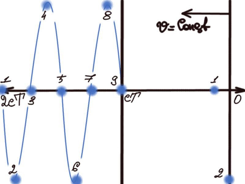

  • #31
frostysh said:
The abstraction there is next: if medium exist then Doppler's effect can define motion in this medium regardles of the inertial frames, and this is me calling 'an absolute'.
I mentioned above the negative connotation of the term absolute above. What you are describing as "absolute" is not the meaning generally ascribed to that term by the rest of the community. By using that term where it does not apply you are being deliberately offensive: going out of your way to use a provocative term that is neither appropriate nor necessary.
  • #32
Ibix said:
It really isn't. You just need to keep track of the velocities of the source, medium, and receiver in whatever frame you want to work in.
No I don't, I simply measure the difference in wavelengths in the rest case of the source and in my case, and the end, I know what is moving what is not — this difference is an invariant. This invariant will be the same in the any other inertial systems.
Dale said:
So, if you look at the link I sent you will see that the general Doppler effect is given by $$\frac{f_a}{f_e}=\frac{1-v_a/c_s}{1+v_e/c_s}\sqrt{\frac{1-(v_e/c)^2}{1-(v_a/c)^2}}$$ where I am using the notation in that paper except for the substitution ##\nu=f## which I use because ##\nu## is visually hard to distinguish from ##v## for me in most fonts, particularly the one in that paper.
If we make the simplifying assumptions ##v_a<c_s<<c## and ##v_e<c_s<<c## then we can solve the simplified formula for ##v_e##, giving $$v_e=\frac{f_e}{f_a}(c_s-v_a)-c_s$$ so assuming that ##f_e## and ##c_s## are known a priori then measuring ##f_a## still does not give enough information to determine ##v_e##, we also need to know ##v_a## independently somehow.
If you don't make the simplifying assumptions then the same reasoning applies, but I think that there is not a closed form solution and you have to numerically solve it.
Cool formulas, but the first one I have very poorly barely understand, the second one no giving any physical explanations, if looking just on mathematics of this formula we will not understand that corresponding to the interiatl frames of observers the wavelength is an invariant. Of course in terms of mathematics and unknown terms this equation no different from the other in case of solving it, if too many unknows we cannot resolve it.
And by the way, usually peoples describing what symbols have what meanings in formulas, because can be missunderstandings... What is means of ##c_{s}, f_{e}, v_{a}, f_{a} ##?
How do you to name the effect that can be used to destroy the equallity of inertial frames of references?
  • #33
Just like the wind speed your observer would measure. Everyone will agree his measurement, and everyone will agree that it is his speed relative to the medium. That doesn't make the rest frame of the medium special.
frostysh said:
How do you to name the effcet that can be used to destroy the equallity of inertial frames of references?
A misunderstanding of what you are doing.

  • #37
A.T. said:
Sure they can. And your word games don't change that.
This is more philosophical question but as you saw, the Doppler's effect is invariant and clearly showing which frame moving, which not. So in this terms 'rest' and 'moving' is not relative, if you can make such an abstraction, you can and model think as a whole Universe is filled by some medium — the end of relativity then in this model, but of course it is not true, the vacuum is not a medium (obviously) and no any 'ether' observed during hundred of years so the relativity rulezz.

  • #42
frostysh said:
The speed of wind is not connected to the wavelength of wind
Wind does not have a wavelength.
frostysh said:
So your wind is useless analogy
I think you don't understand my point. Measuring the speed of the wind simply tells you your speed relative to the medium, whether you regard yourself or the medium or both as moving. That measurement is invariant - everyone will agree it. That does not make your speed invariant, merely your measurement of speed relative to the medium.
Sure, the wavelength is frame invariant. However, as I said, neither the frequency nor wavespeed is frame invariant. Thus your measure of frequency simply gives you your speed relative to the medium (assuming you know the speed of sound relative to the medium in order to subtract it out).
Do you understand that wave speed is frame variant? Because that seems to me to be the bit that you keep missing.
  • #43

  • #45
frostysh said:
we can distinguish where is the movement, in observer or in the source
No - you can distinguish where there is movement relative to the medium.

  • #50
On another note, if you can measure the wavelength and the frequency and if ##c_s## is known then I think you can make two equations in two unknowns and solve for both the emitter and the absorber’s speed.
My analysis above presumed only measuring the frequency, since that is the usual meaning of the Doppler shift.

The all holy saints! I need to describe this diagram earlier. Actually, on my current level of understanding this phenomena it is the difference! It is the true! Why source moving with respect to the medium is not the same as medium moving with respect to the source, because the creation of the waves is an event, and those beacuse it is not more general than Galelean relativity! So in the model we just using a very special event which killing relativity, nothing special, nothing fundamental. Hoorey!
On primitive level I have described it by this picture,
as we can see the change of wavelength is the physical, this is an event, as the breaking of a brick. The explanation of the picture in the first post. If you will move the medium instead, no any change in wavelength appear, because interraction is instant and the speed of medium related to source have no any connection to the very position of the 'cores' related to each others, which is an anlogy in respect to some points of model of one-dimension wave.

I get the impression you are trying to imply that I'm stupid for not following your argument. Am I correct?
No it is not. It's an extended period of time.
...and it happens the same whether you regard the source as moving with respect to the medium or the medium with respect to the source. Proof:
Let the source emit waves of period T and speed c. The medium is stationary and the source moves in the same direction as the waves at speed v. When the second wave crest is emitted, the first wave crest has traveled ##cT## and the source has moved ##vT##. Thus the wavelength is ##(c-v)T##.
Now again, but this time we regard the source as stationary and the medium as moving at speed ##-v## (i.e., we've subtracted ##v## from the speed of both medium and source). When the second wave crest is emitted, the first has traveled ##(c-v)T## and the source has not moved. Thus the wavelength is ##(c-v)T##.
No difference.
