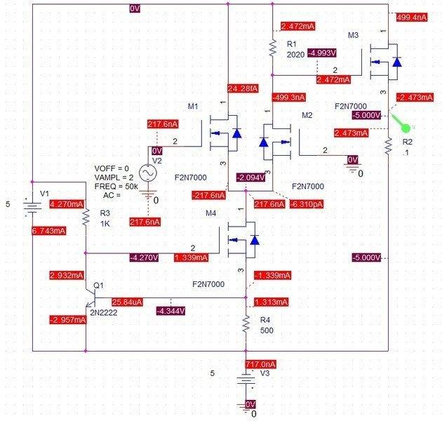

I need to design a unity gain amplifier for a sample and hold circuit. I've decided to use the circuit shown in the attachment. Now I know the gain = 0.5(Gm2*R1)[(Gm3*R2)/(1 + Gm3*R2)]. The 2N7000 has a Gm of 0.1, so that gets me the values of R1 and R2. I don't know if these are good values to use. Components Q1, M1, R3, and R4 comprise the bias current source. Obviously, I'm not understanding the theory behind the circuits. I hope someone here can help me understand this better.
Thanks a lot,

Several things jump out at me in this circuit for your specified use. First is that M3's current is 500ma, now for a switching function that's ok, but as an amplifier that seems quite high and it will get hot at that drive. M1 & M2 are set in a differential mode where Q1 & M4 provide a constant current source for the differential setup. I think of the differential amp as a seesaw, it is balanced where at quiescent the same current flows through each leg (drain here) and as a signal difference is presented across the gates of M1 & M2 that balance is changed and amplified by the resistors in the drain circuit, in this case R1. This setup provides a very high input impedance and a potentially high gain at R1. R1 sets the impedance output of this setup and normally needs a power output stage to provide a lower impedance output. If you look at a LM741 circuit you will see the similarities of BJT form, but same setup (R1 is replaced by active transistor impedance in the 741). Because you are seeking a unity amp, you have chosen values for R1 & R2 that work in your equation, but are way out of norm for an amp for this function. Total current for this function should be in the 10ma range for the entire circuit.
Then there is the fact that the input is shown as an AC source, this amp will only operate as an amp on signals within the rails (between 0 & V+) and there needs to be head room in there to allow for the bias circuit and range of R1 to stay linear. If you are going to need to use an AC source as input, you will either need to supply your circuit via a -V instead of ground on the lower side or offset your input voltage. Likewise the way the circuit is drawn the gate to M2 is at the bottom of the voltage source so the difference is referenced there. As such the only signal that will be in linear range is positive swings of the AC input. But the M2 gate tied to gnd is problematic just to start. There are several ways to go to achieve what I think you are looking for, but you will need to decide which way and we can help you from there. You could also choose a high gain and employ feedback to stabilize the overall gain back to 1.
I like the seesaw analogy. I forgot to mention that I don't know how to choose the bias current value also. The 2N7000 in this circuit is a custom part and I'm not sure I attached the pin numbers to the right label (gate, drain, source). The data sheet doesn't say which number is which.

I see what you mean by only outputting the positive side of the input. I've added a negative supply to the bottom, but this changes the voltage to the base of Q1 to around -4.34 V leading me to believe I need to replace that with a PNP transistor. I've attached the new PSpice analysis.
Using feedback to get the gain back to 1 sounds interesting, but I don't know enough about using feedback. Isn't there a possibility that the output will be a little off from the input with this method?

Is this for a one time circuit? Is there a reason you want to use discrete parts? You can accomplish this with one op-amp in a smaller footprint and much lower currents with no external components. A LM741 or similar with your input signal tied to the + input and the output of the op-amp tied back to the - input is a pass through buffer with unity gain and high input impedance. If your input signal is AC with voltage swings above and below gnd, then you will need a V- supply (the swing of your input signal should fall within the supply rails and just a bit more; if you are trying to buffer a 9 v p-p signal then the +5 & -5 should work any input less than that will be fine. You state that this circuit is the sample and hold, but the posted circuit is only capable of buffering. Again, there are chips and circuits that will do the sample and hold with much less hassle then this.
I love the 2N7000 and have used it many times for switching, but true differential setup with minimal offset will require the M1 & M2 transistor be matched, so usually in the same package, 4 in an IC chip so the silicon, temp, and mask are matched. This insures their response Vgs and Gm are equal, at least as close as possible.

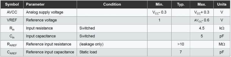

That's a great tip! The attachment shows an example and it looks like the input voltage is 0 to Vref. I'm not sure what the other two Vin's mean. The design parameters didn't include the input voltage range, just the maximum frequency, which is 100 kHz.
The emitter-follower I attached is good enough for my purposes? R1 and R2 will have to be in the 100k ohm or higher range to get the high impedance input?

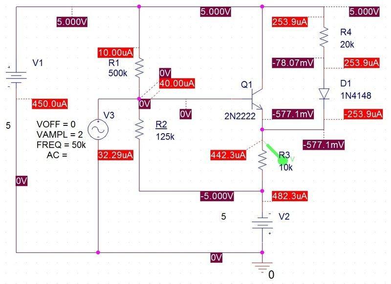

Oh I know to use resistors to bias the diode. I just don't know where to connect the other end. I tried the connection shown in the attachment, which I know is wrong, since I'm getting the wrong output. I just realized that the diode is not forward biased in this circuit. Adding an Rc resistor changes the output voltage at Ve.
Thanks,
Mike

Mike, I owe you an apology. I said collector and I meant emitter. The cathode attached at the emitter and a resistor from the anode to +5 top rail will forward bias the diode and your anode will be approximately 0.6 v above the emitter. But Alephzero also has a good suggestion of using the offset on the A/D reference circuit.
Welcome to design engineering! You always have choices and I have struggled at times with two good solutions trying to determine which is the best. Ultimately you must decide a direction and implement.
Again, I'm really sorry for stating the wrong leg.
mitch
Oh no problem, we all make mistakes. We wouldn't learn anything if we didn't.
That makes better sense. Right now it's cutoff around zero. The negative portion of the signal is cutoff.

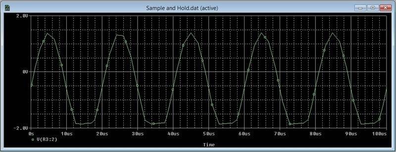

Alright, here's what the circuit looks like now. The results are wrong though. I can't seem to get a 0.6V difference between the cathode and anode of the diode, perhaps because of the specific diode I'm using in the simulation. Also attached is the output graph. The negative side is partly clipped.
If I was to offset the reference voltage, how would I do that? I'm allowed to use a DAC chip and that has a Vref input. Can I use that input to offset the reference voltage? If I go that route, it may be a good idea to use a potentiometer in place of a resistor so I can adjust the reference voltage to match the offset more precisely.
