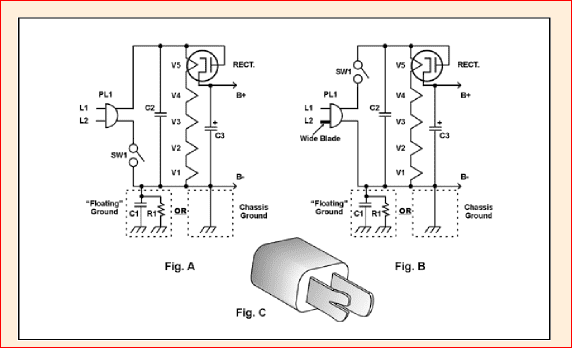

Thanks for the help. I'm setting a bench up with safety in mind. I'm worried about getting zapped. I was curious if connecting the bench to Earth would help that. I bought a Dc power supply and I have other standard equipment: 2 meters, soldering iron , Magnification lamp.
Myself i prefer a nonconductive benchtop. A metal bench with frame earthed is fine but the flat working surface i would make of wood or cover with carpet.
Why ?
Many table radios from 1940's to 1960's have the metal chassis connected to one side of the power cord.
So,
when the chassis is removed from the case for work,
it is easy to grab a handful of house power.
Setting such a chassis on an earthed metal surface can be an exciting event to witness.
That happened to a friend of mine - but only after he'd got false confidence built up. The non- polarized power cord would go into the socket either way and third time was the charm for him..
http://antiqueradio.org/safety.htm
See that L2 to Chassis connection ?
One must form the habit early of always checking first thing for continuity between power cord and chassis, and power cord to circuit common.

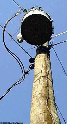

If one is protecting against shocks from utility power
Kirchoff tells us that any current beginning at our utility transformer will do its best to get back to that transformer.
That transformer's center tap is its 0v reference point and is, in US, connected to Earth .
On a pole mounted transformer it's 'earthed' by this bare copper wire coming down side of the pole. The bare wire is coiled on the bottom of the pole to have max surface area contacting earth.
In my neighborhood it also goes on up to very top of the pole where it serves as a small lightning rod.
power-ground.jpe
from http://www.science.smith.edu/~jcardell/Courses/EGR220/ElecPwr_HSW.html , a pretty good link.
Your household 'grounding' conductor is also tied to it by the third bare wire coming in from the transformer.
So the household ground system is good at protecting you from utility power. That's why i'd use it for my bench.
