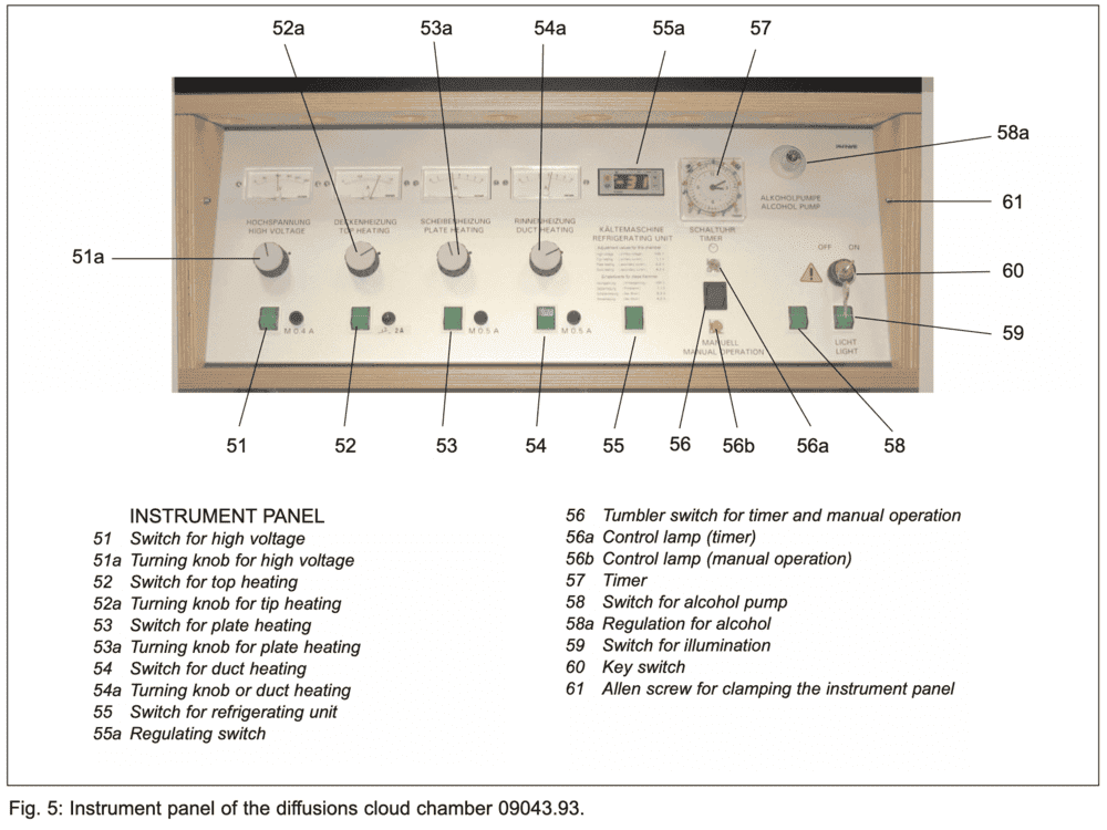

I personally had to be sufficiently disappointed with about 8 different weak-sauce failures of my various fully constructed glass-aquarium designs before I dug deep enough into the literature to reveal the significance of the HV field. In that light, anyone who has had trouble getting a cloud chamber to work right, would perhaps have to fail another seven times in order to obtain the necessary level of frustration I found was required of myself in order to motivate me to crack the puzzle.
You'll find that PHYWE, a German manufacturer of museum-quality cloud chambers, considers the HVF important enough that they organize those controls first on their control panels (51a and 51 below):
The above is from the PHYWE PJ80, but they also have HVF in the PJ45. If anyone is looking for all of the answers in one spot then I recommend you look at their lab guide from 5.2.04, called VISUALISATION OF RADIOACTIVE PARTICLES / DIFFUSION CLOUD CHAMBER.
Here are links to the complete user docs for the PHYWE PJ45 and the PHYWE PJ80, you'll find them to be UNBELIEVABLY INFORMATIVE. I give complete credit to the engineers at PHYWE.
Once you have time to soak up all that good info, please circle back around and get back in touch if you can, as I may need the help of others in cracking a few puzzles I still have unsolved on my balance sheet. Puzzles like "why are muons blowing completely through my chamber at an almost identical orientation to each other?" and "how can most easily demonstrate the curved paths that differentiate regular matter (electron) from anti-matter (positron) in a magnetic field" and "is it possible to make a floor of the chamber as dark as Vantablack is?"

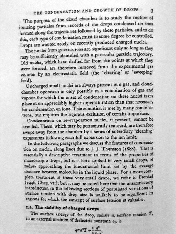

P.S. Pick up a Sodium 22 disk and you'll have your own beta+ emitter and can thusly observe antimatter doing it's thing, namely being an electron with inverted charge (positron). That might shake up the science fair. I bet you already considered it. Great work man thanks!
"Old nuclei, which have drifted far from the points at which they were formed..."?? :wideeyed:
Kosdon3200 said:
I think they mean cations or bare nuclei.
Right, "condensation nuclei"
