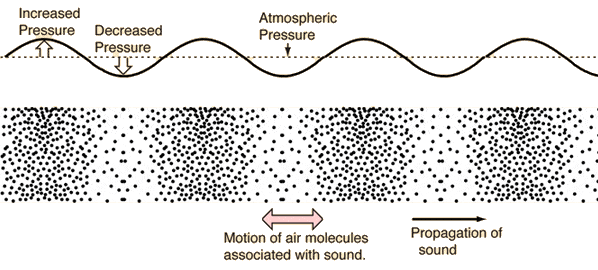

Sound waves in air are longitudinal

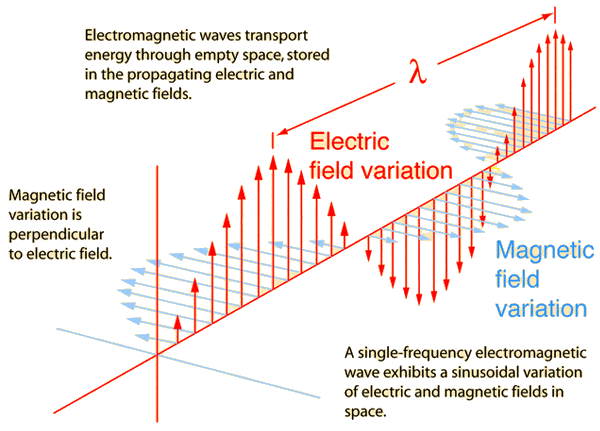

and electromagnetic waves are transverse.

I can explain that soundwaves and electromagnetic waves are two different types of waves that travel through different mediums. Soundwaves are mechanical waves that require a medium, such as air or water, to travel through. They are created by vibrations and can be heard by our ears.
On the other hand, electromagnetic waves are transverse waves that can travel through vacuum, such as in space. They do not require a medium and can travel through air, water, and even solid objects. These waves are created by oscillating electric and magnetic fields.
