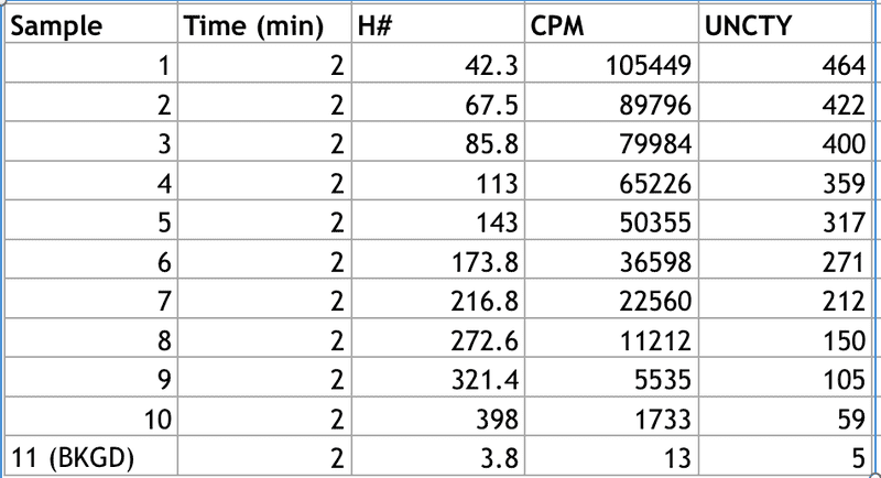

I'm doing a lab report and for every number we need to calculate the uncertainty. I tried to calculate by using the SQRT of the number but i didn't get the same answer as my partner had?
could you help me!
These are the numbers and the uncertainty of my partner which i could not figure out how it was done!
Table with columns Sample, Time (min), H#, CPM and UNCTY. Rows 1 to 10 each have a time of 2 min, with H# rising from 42.3 to 398 and CPM falling from 105449 to 1733. Row 11 (BKGD) shows H# 3.8, CPM 13, UNCTY 5.
It appears the uncertainty was calculated as
##\sqrt{2CPM}##.

Thanks RUber for the fast reply.
Are there any other way to calculate the uncertainty ?
And how can i know I'm using that right way?
Normally, the uncertainty comes from your measurement tool, or from the process itself.
Without more information about the expected relationships between your data, I am not sure why you would choose one method over another for uncertainty estimation.
In this document (http://instructor.physics.lsa.umich.edu/int-labs/Statistics.pdf) there is a reference to the "square root rule," which generally says if you know nothing else about a number (large integer), the standard deviation is the square root of the number.
Assuming CPM is a measure of some C per minute, then it might make sense that your count for 2 minutes was 2*CPM.
Then the uncertainty in that measurement would be (using square root rule) ##\sqrt{2 CPM}##.
