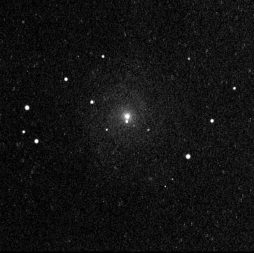

Just an additional question spacetiger and then this is it haha : )
I took a picture of a galaxy which is meant to be of size 10.2 x 9.5 arcmin (M74) and it fits perfectly in the middle of the picture taken by the ccd on the telescope. But the thing is the field of view of the telescope is 10 arcmin. So wouldn't the dimension with 10.2 arcmin be slightly truncated?
I've attached the pic.
It's hard to say. Either number could be an approximation or misnormalization. I wouldn't worry about it.
