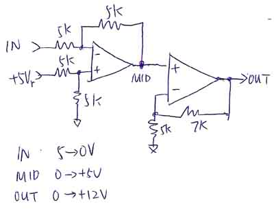

Basically i will have a rangefinder with an analog output. I want to invert and multiply that output. So that farther readings will result in higher voltage to a motor. Also, the multiplication will be very small, like 5V to 12V.

Is multiply mean gain to you? Is the input 0 to +5V and you want the output 0 to -12V?
What speed is the voltage change? What is the driving requirement of the motor that the circuit has to drive? What I mean is how much current you need to drive the motor.
Usually all you need is a simple op-amp inverting configuration with a gain of -12/5 = -2.4 if that is what you meant but multiply.

My sensor will output a voltage based on distance. For farther distances it will output a lower positive voltage, but I need a high (still positive) voltage to the motor. Close objects will out put a higher voltage, but I will want a lower(still positive) voltage to the motor. So a close object will approach 5v and the motor voltage should approach 0v, then a far object will approach 0v and the motor voltage will approach 12v (or whatever max motor voltage ends up being).
I don't know about motor current because I haven't purchased a motor yet. I was trying to get the design more concrete before I did. I was thinking of a 12vdc scooter motor or something similar.
Voltage change doesn't need to be anything particularly quick.
This is one way to do this:
Input from 5V to 0V will give output of 0V to 12V. This is my understanding.
Use a dual op-amp. If you can find a rail to rail input and output op-amp, you need only a single +12V power supply. But if you have +/-15V supply, then any dual op-amp like TLO82 etc will work.
You can do it with a single op-amp, but the resistors are going to be harder to match and op-amps are cheap. I called for 5V reference driving the resistor divider just for convience. I need a +2.5V at the +ve input of the first op-amp, however which way you want to get it is up to you.

Thank you for the detailed answer. I probably could have never gotten that far on my own.
