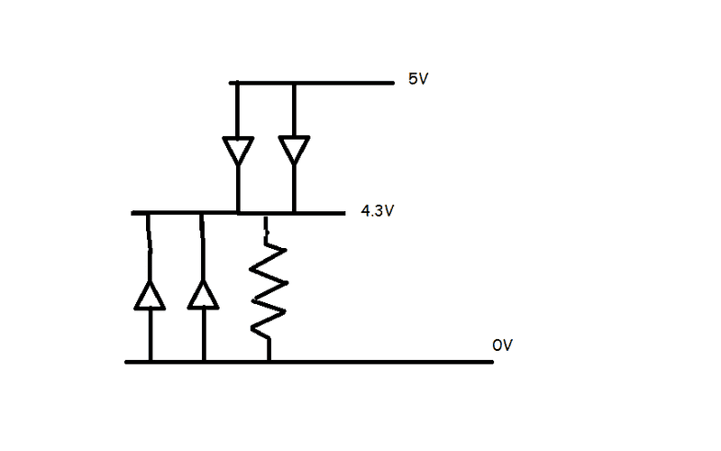

can i understand at OR gate with diodes , why o/p not equal the sum of two voltages (5+5=10v) , it's confusing me ?
I have no idea what it is that you have imagined.
in OR gates as we have high(5v) on both two diodes why the result equal 4.3 as practical approximation ?
why don't we sum the two voltages resulted from two diodes ?
we only sum voltages when they are connected in series.
Are yours not in parallel at the cathodes?
Have you a diagram from which you are working?
Why should we sum them? Or, why would we?
The diodes simply connect the output to the 5V line (via a 0.7V drop)
Once the connection is made, further connections don't do anything new.
Since we have only 0 and 5V lines, all voltages in the (passive) circuit will lie between these two values.
If the top diodes were removed, the output would drop to 0V.
If 1, 2, 3 or 4 diodes connect to the 5V line the output is simply 5V less a diode drop.
so i consider if one works the o/p would be high non-caring case of other diodes , that right ?
finally thanks my professor :)
Yes. Any diodes connected to a low voltage are reverse biased, do not conduct, so have no effect.
The resistor connects the output to low, but if any diodes are connected to high voltage, they conduct and raise the output to 4.3 V.

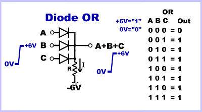

If he showed you a circuit like this...
The + sign is the logical operator for "OR" not "add the voltages".

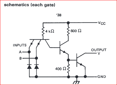

Using the way back machine, I remember circuits with open collectors and simply wiring two signals together to get a virtual or gate. They were called "wired ors".
SN7438
Ah, the good old days!
A time when nothing worked right and inhaling lead based solder fumes was every EEs life quest.
Still used today... I think the Raspberry Pi has an I2C bus and (if the lead in the solder I use hasn't affected my brain) I think that uses an open collector/wired OR system.
