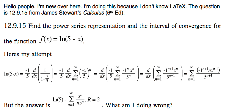

See the attached png

Well, it looks like you're trying to find the power series of ln(5 - x) by differentiating the series for 1/(5 - x) term by term. But ln(5 - x) is the integral of 1/(5 - x) (give or take a sign).
In other words integrate, don't differentiate!
Oh. how stupid am i. God help me in my exam.
