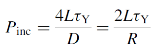

I have three questions.
1. How do I calculate the yield pressure for a Bingham plastic in a tube if I am given:
Length of tube
Diameter of tube
Yield stress of liquid
2. Is it possible to engineer a liquid to have a specific yield stress ?
3. What kind of material would be suited for engineering a specific yield stress? Could it be done with silicon oils or could it be done with additives to water?

I don't quite understand your first question. Are you asking how much of a pressure difference is required before the bingham plastic begins to flow?
Yes I am asking how much pressure difference is required for flow. I think that I have read somewhere that a larger initial pressure is required for small diameters.
Hi Chester
You already answered the first question for me. I was googeling yield pressure and getting nothing. The right words were the ones you used in your reply to me:)
I still need answers for the two last questions.
The formula is:
Found in this PDF
http://onlinelibrary.wiley.com/doi/10.1002/9780470516430.app7/pdf

The formula is:
Found in this PDF
Nicely done. For questions 2 and 3, I recommend that you google Bingham plastics and dilatent fluids and see what you come up with.
