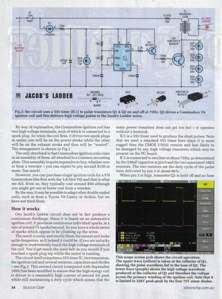

After learning about the 555 chip I redrew the circuit. Now I have the ten 9V batteries hooked up in two parallel packs connected in series, giving an output of about 18V. From the battery the current splits. One branch passes through a resistor, reducing the voltage to about 12-15V, then enters the 555 chip. The other branch passes through the collector of a TIP31C transistor whose base is connected to the output of the 555 chip. The emitter of the transistor then hooks up to the transformer and returns to ground.

I remembered that the Australian electronics magazine Silicon Chip published a circuit for a "Jacob's Ladder" that uses a car ignition coil as the transformer.
So it is essentially what you need.
I did not read the article, so I don't know what the output voltage is, but it certainly provides an arc.
Note that they use a lead acid 12 Volt battery.
I have attached a scan of one page, but I can scan the rest for you if you wish.
Also, you can buy the printed circuit board for the project (and other projects) from a company that is based in Sydney.

  • Magazine page showing a 555 timer Jacob's Ladder circuit schematic with transistors, a car ignition coil, and a waveform screenshot from an oscilloscope. Caption: Fig.2: the circuit uses a 555 timer (IC1) to pulse transistors Q1 and Q2.
