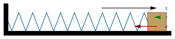

How do you calculate 'g' when the length and the period is known for a pendulum
I know you do it by rearranging this equation T = 2π√(L/g).
But how exactly do you prove that equation??
just curious...:rolleyes:
I don't know what your teacher wants but
the way that I would do it is to approximate the pendulum with a mass spring system.
The equations for a mass spring system are pretty easy.
You should be aware though that a pendulum doesn't perfectly resonate.
The restoring force isn't perfectly linear.
But for very small angles it approaches quite closely to it.
http://en.wikipedia.org/wiki/Simple_harmonic_motion#Mass_on_a_simple_pendulum

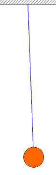

okay... then is there an equation that is not an approximation??
Also, is it safe to say that the mass of the pendulum and the angle at which it is released does not change the period (assuming no air resistance and friction)?
I am a high school physics student and i have done mass/spring systems
wow...okay...you are saying the value of T is different with a small initial angle and a large initial angle
but some sites say the period is not dependent on the initial amplitude, such as this one
http://muse.tau.ac.il/museum/galileo/pendulum.html
which stated " Galileo examined a variety of pendulums and claimed that the period of each is totally independent of the size of the arc through which it passes. A pendulum with an angle of 80 degrees has an identical period to that of a pendulum with an angle of 2 degrees."
oops...i did not read the next part which said why galileo claims were wrong
okay i get most of this now
thanks a lot for the replies
