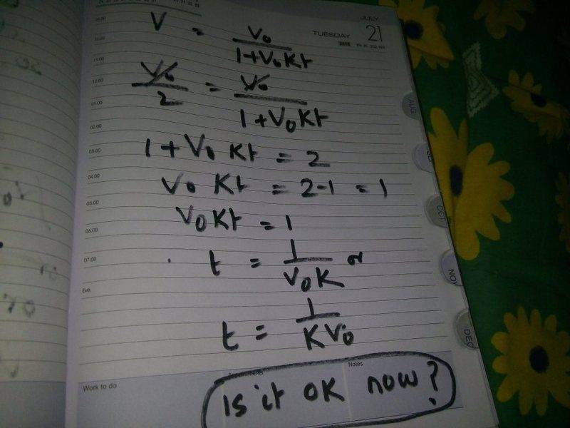

  • #33
but how will i get a numerical value like 0.693 in numerator by splving this . i am not getting what to do , ?
  • #34
but how will i get a numerical value like 0.693 in numerator by solving this by integration to obtain S .
i am not getting what to do , ? Totally puzzed , please do the rest please
  • #35
Start by using the velocity equation to find the time at which the velocity is half its initial value.

  • #44
Supposedly you got the velocity, and then all you've written about getting the position is "failure failure failure."
Here's a hint: Try again.
The relationship between acceleration and velocity is analogous to that between velocity and position. If you understood how to get v from a, it's exactly the same mathematical process to get x from v.
  • #45
romiomustdie said:
Please show
dx=Vdt
